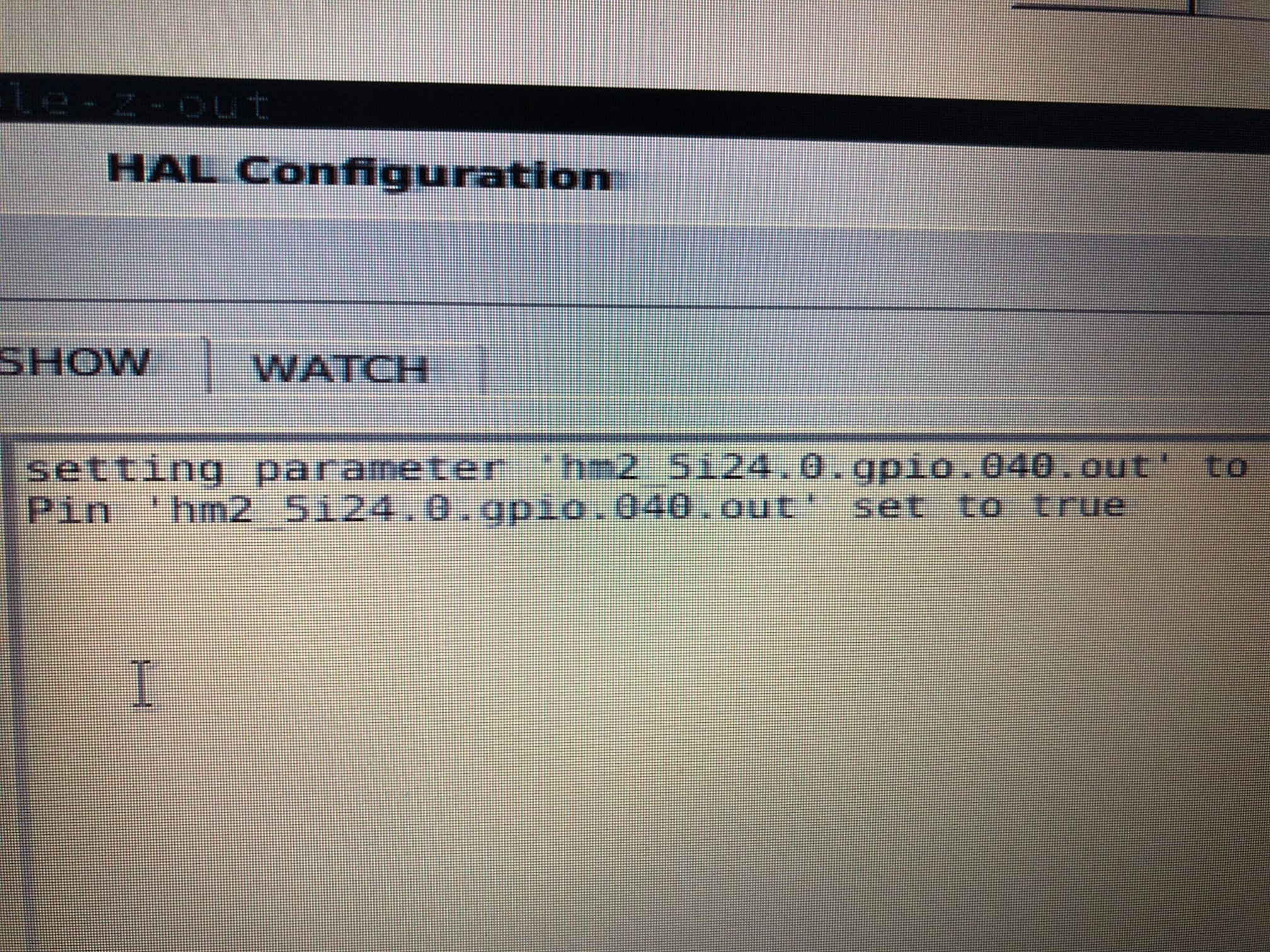

I’ll check wiring
Have set all the output pins into my hall file
Output 40 till 47 to be true (see attachement before)
Setp hm2_5i24.0.gpio.040.is_output true
But still no output, have put 24 volt on + and measure on - output pin to ground, also don’t measure signal on gate of mosfet

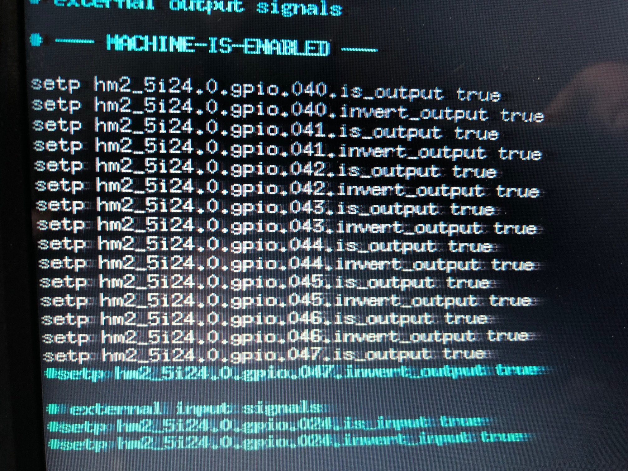

Did you set the is-output attributes of the GPIO pins you need to be outputs?
If not you can change the output state but the external pin will remain an input (and stuck high)
Last edit: 09 Feb 2018 14:04 by PCW.

Replied by PCW on topic mesa 7i47S as 3 axis stepper driver
OK that looks right (for a 7I37TA on the middle 5I24 connection)
If you toggle the output state of say GPIO040 does the GPIO040 input state also toggle?
( the input GPIO pin reads the external pin state )

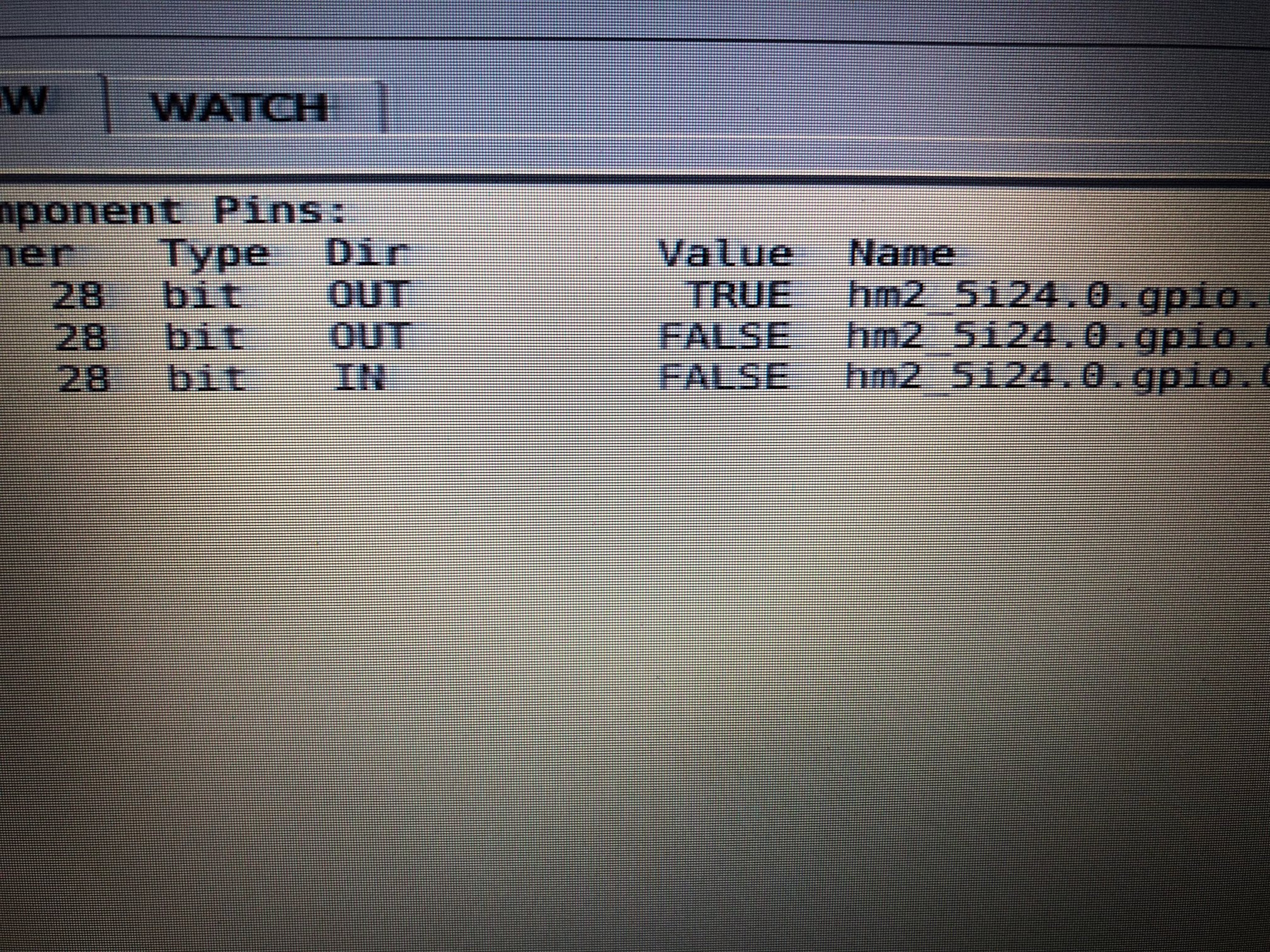

If i toggle the output of GPIO040 , the input does not toggle,
- Posts: 18105
- Thank you received: 5328
09 Feb 2018 15:11 #105640
Make sure you are using watch or halmeter ( "show" doesn't show the current state of pins )
If "watch" or halmeter don't show the inputs following the output state ( and the is_output attribute is set for that pin)
this suggests that the watchdog has bitten
