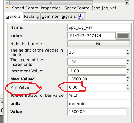

How to change glade "speed control" widget to negative value was created by Grotius

I would have thought that putting a negative value in the Min Value box would have allowed this. I would also check the python screen handler and maybe the ini file to make sure they are not overriding the values in glade. I think Gmocappy keeps a preference file that may need deleting.

I'm not sure if you are on the right track (or indeed if you are using Gmocappy. I've circled the min value I was referring to in your earlier screen dump
Having a value of 0 here limits the range to a positive value
But the Gmocappy python screen handler overwrites these values as this small snippet shows:
and if you look at the Gmocappy plasma sim which I am more familiar with, you will see that these values are also stored in a .var file (plasma.var)
So for this screen, there is plasma.glade, plasma.py and plasma.var to take into account. In this case, I found you needed to change the plasma.py defaults and delete the plasma.var file before changes in glade actually stuck. I can't see why negative values are not allowed.

The negative value is now working in the speedcontrol widget. I had to do some research.
Problem is solved. I mentioned that the glade program is not very well suported with examples.
In the Gmocappy python code you can do a negative "min" value for example jogging, this works perfect.

Leader of the widget is the top level gui that includes the widget.
So gmoccapy overwrites some settings from speedcontrol.py
But speedcontrol.py does have limits hard coded. That limits can not be passed by the main gui.
So in your case you need to check the limits in lib/python/gladevcp/speedcontrol.py
And /usr/bin/gmoccapy
I just pushed a bugfix to speedcontrol a few days ago, related to misbehavior at very low values.
