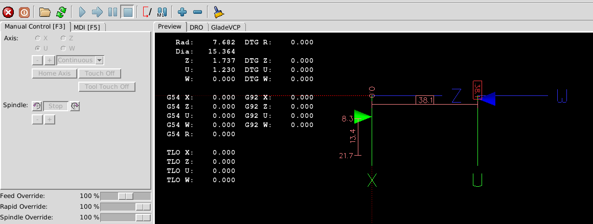

Hi all,
Im building a dual turret lathe, and linuxcnc controls XZ;UW axes. So far I have managed to get this display (in the attached file)
I have two problems with the display:
The tool wont move in Z or W directions (on the display). only in X and U directions.
Please point me on what should I have to modify to get a proper display of axes movement.
The other thing is that only the X axis is displayed as Rad/Dia, the U does not. And should be.
How can I modify this?
Im using linuxcnc 2.7.11
And the display config relevant sections here:

I think that you probably need changes to hal_gremlin.
You might get some ideas what needs to be changed by looking at the commits that added XY / UV hot-wire foam cutting support.
github.com/LinuxCNC/linuxcnc/search?p=3&...&type=Commits&utf8=✓
(And it might be interesting to see what happens if you put FOAM=TRUE in the INI.

Thanks,
Actually FOAM is set to 1 AND LATHE too. Without the LATHE option set, it draws it vertically. But it is a horizontal machine.
I will look into the axis.py, but Im not a big python fan.
