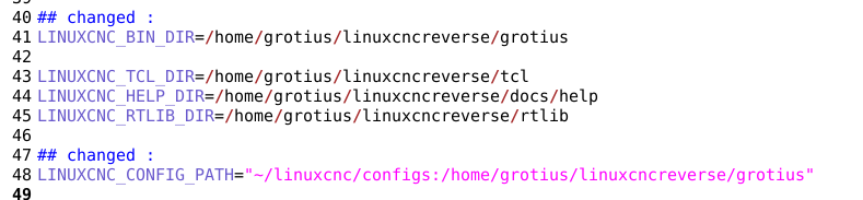

I have an option for those who are done with spreading linuxcnc project's over different directory's and places around.
For example now you have :
- bin (for your python file)
- share / linuxcnc (for your glade file)
- config / sim (for your ini, hal, postgui and ... files)
I have :
- one directory for all files.
So how to do this, is not very difficult.
Step 1, change in your linuxcnc file "linuxcnc.py" your directory path's to one place. The file is located in the script's directory.

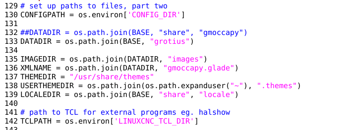

Step 2, change in your python project file, for example here gmocappy.py , your path, in my case Grotius directory.
This file is mostly of time located in bin folder.
Step 3, the place of your glade file is already changed in the datadir section in Step 2.

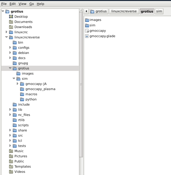

At the end you have one project directory. It saves you much time and frustration when you are working one a project.
See project structure picture, example for gmocappy project :
Advise, first copy the orginal and rename it to linuxcncorginal.py So you can always go back 1 step, if you mesh things up.
