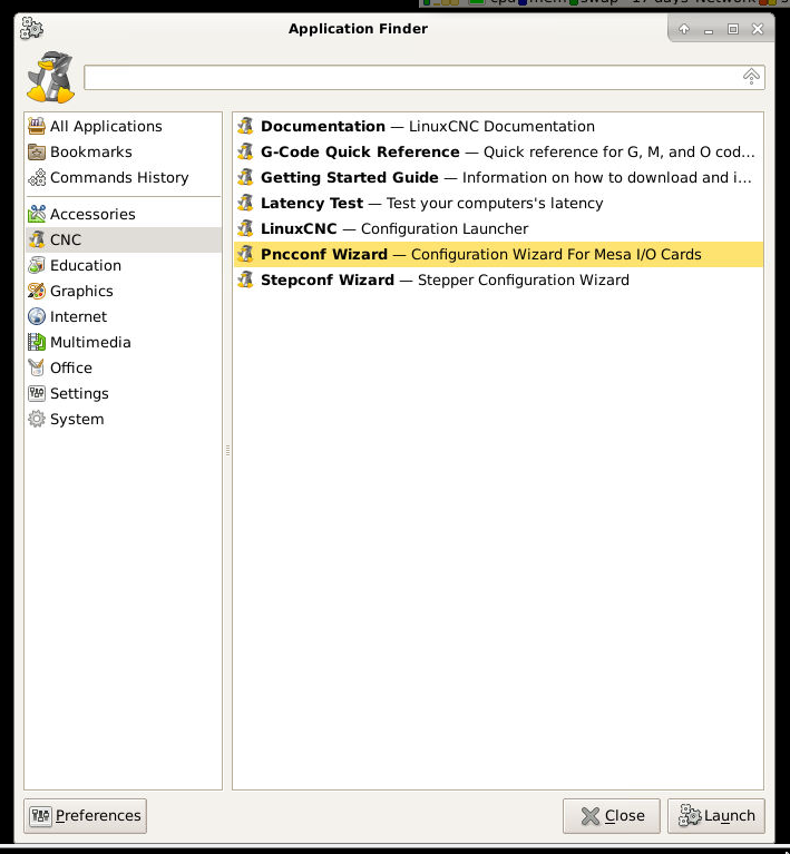

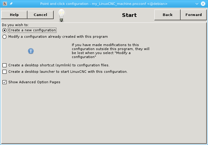

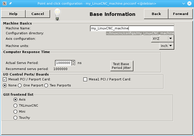

Basic 7i76e set up (in software):
Good News: LinuxCNC has a wizard
Bad news: It's far from complete
1) LinuxCNC is a stand-alone operating system install it on a decent computer
2) Boot LinuxCNC open a terminal
3) run "pnconf" this will guide you through a configuration wizard making your 7i76e setup file
4) pnconf creates : "/home/yourUserName/linuxcnc/configs/yourConfigFileName/yourConfigFileName.ini"
5) also pnconf creates : "/home/yourUserName/linuxcnc/configs/yourConfigFileName/yourConfigFileName.hal"
6) make all the changes you can using pnconf then DON'T USE pnconf again, it will change things without you knowing
7) there is a ton of TWEAKING tweak the ini and hal files util you get it working -- have emergency stop switch ready
8) test config by running "linuxcnc" in terminal selecting your machine and exploring menu bar to allow you to edit ini and hal variables while in linuxcnc ... you can tranfer them manually or via save buttons
What kind of machine axis count ect did you make?
