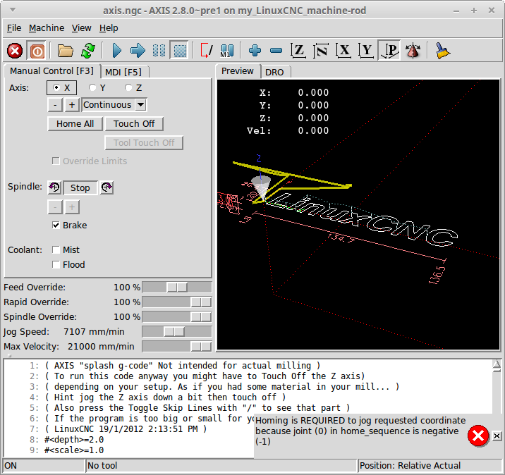

When i do multiple homing command's i get error : Must be in joint mode.
So i was looking to solve this. This error is only for latest update linux users.
It's very difficult to solve.
Here a code example of a homing all axis button :
Do someone know to solve this?

It looks like traj_mode isn't true/false:
traj_mode(int)
set trajectory mode. Mode is one of MODE_FREE, MODE_COORD, or MODE_TELEOP.
linuxcnc.org/docs/devel/html/config/python-interface.html

Your problem could be related to a regression in the latest source code for master branch I identified on the weekend. Previoulsy attempting to jog before homing on a machine with a joint axis raised an error message
Currently, this test is ignored so attempting to jog before homing is badly buggy.
Because of the regression, before homing, Joints are mapped to axes as follows X=0, Y=1, Z=2 and to hell with any other joints which are just ignored.
In my case with a YYXZ, the gantry is racked as only one side is moved.
Clicking on home all solves the problem. The machine homes correctly and axes with multiple joint then jog in unison.
This is restricted to the Axis GUI and Gmocappy works fine, probably becasue I identified this bug over 12 months ago and Norbert fixed it.
