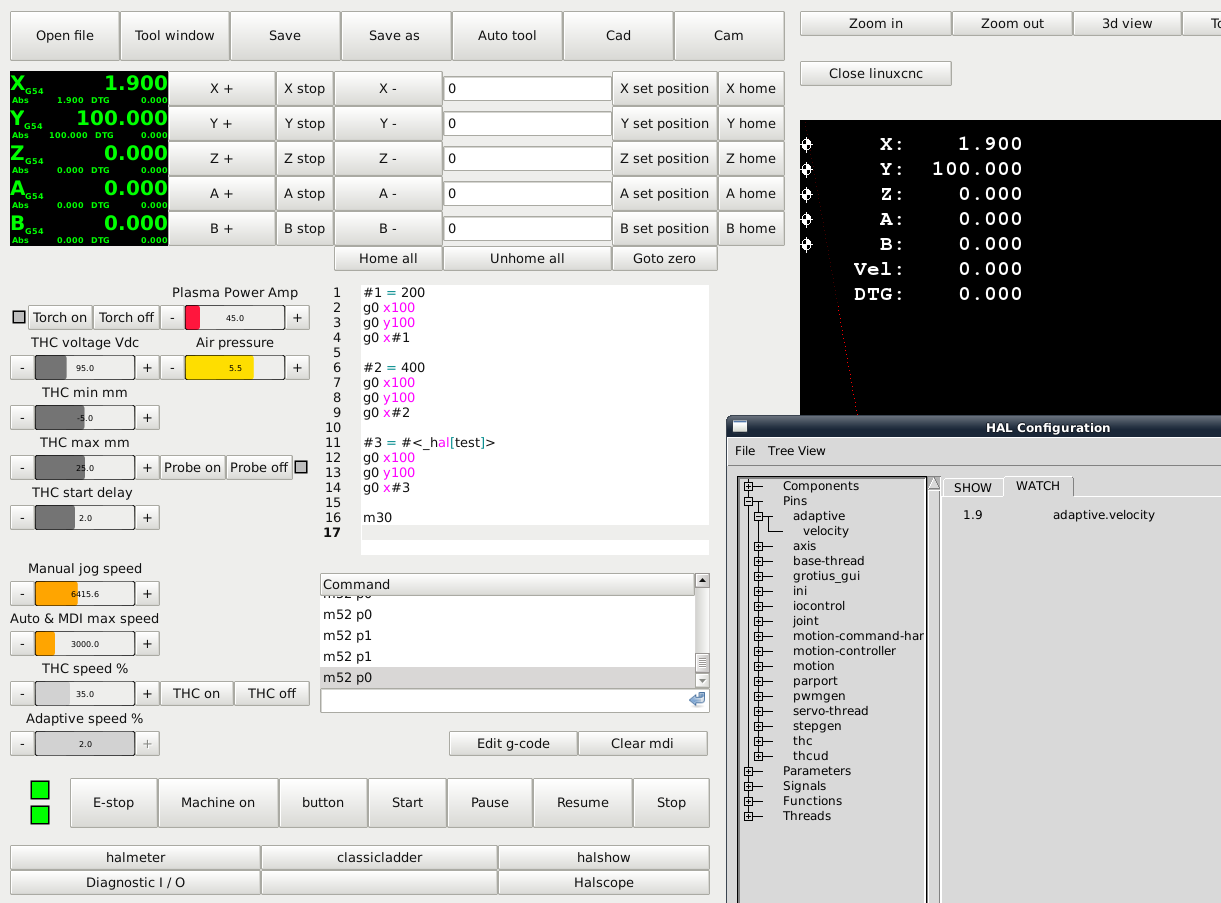

@update,
Okey it is working now.
I had to do a postgui.hal thing :
net test adaptive.velocity
So now i have " test " used as g-code variable and that's working if you do it in combination like this :
So you have to : #3 = #<_hal[test]>
You also have to add in ini file :
[RS274NGC]
FEATURES=12 ( source linuxcnc forum )
This feature is loaded at the line. If you change the variable after that, it is not responding realtime.
So that is no problem for me.
#1 = 200
g0 x100
g0 y100
g0 x#1
#2 = 400
g0 x100
g0 y100
g0 x#2
#3 = #<_hal[test]>
g0 x100
g0 y100
g0 x#3
m30So you have to : #3 = #<_hal[test]>
[RS274NGC]
Now i can expand this function with tool list for plasma. And make a special postprocessor that lives on variables.
Tommorrow i wil try to make dxf2gcode working. After that i can make the variable based postprocessor for the selected plamsa tools.
Last edit: 14 Feb 2018 18:55 by Grotius.

Replied by Todd Zuercher on topic How do I read current system variable into my Gcode program?
Your "adaptive.velocity" is a hal pin. Hal pin values are not normally available as G-code parameter values. And they certainly are not available in real time as/if the hal pin value changes during the run.
There is a way to read a hal pin value but it is kind of kludgey and the values can not be trusted if the hal pin can be expected to change it's value during the run.
By inserting the line "FEATURES = 8" under the [RS274NGC] section of your ini file will give you a set of read only g-code parameters for hal pin values. (for your example #<_hal[adaptive.velocity]>
linuxcnc.org/docs/html/remap/remap.html#...i_file_configuration
But like I said the values are read when the g-code file is started, and they are not updated in a timely fashion during the run.
If you want accurate updates of hal pin values to use in your g-code file it much more reliable to use motion digital in and analog in hal pins and M62-M68 commands get those values into g-code parameters.

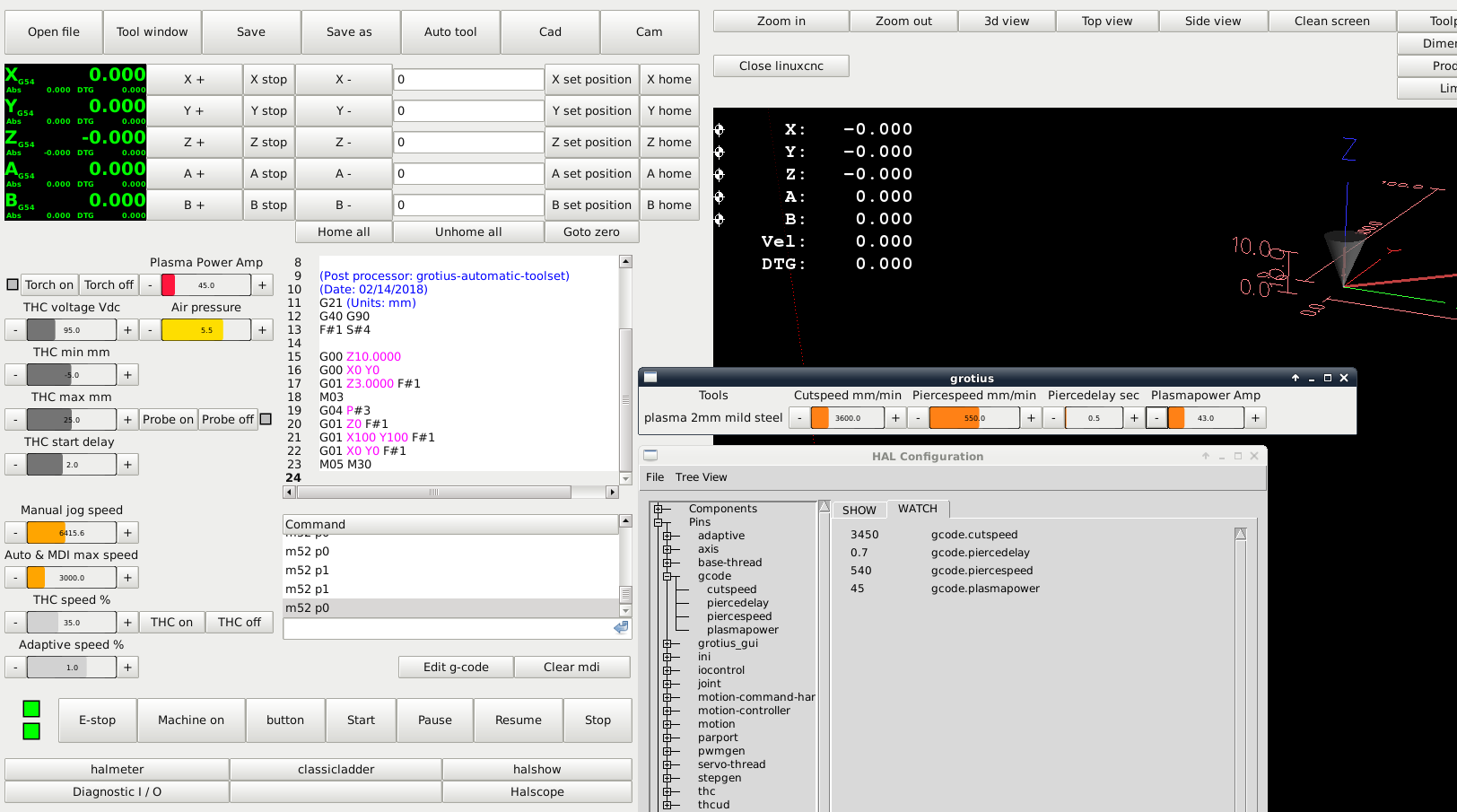

@Todd,
This is very good info, thanks.
I have now made a program example for selecting plasma tool from a tool library i made in linuxcnc.
And it's working perfect.
I will look to integrate dxf2gcode on a sercain way. I noticed that the installing of dxf2gcode is a problem on itself.
This is the gcode program i have loaded :

(explanation)
(variables : #1 = #<_hal[cutspeed]> F#_value)
(variables : #2 = #<_hal[piercespeed]> )
(variables : #3 = #<_hal[piercedelay]> G04 P#_value)
(variables : #4 = #<_hal[plasmapower]> S#_value)
(Post processor: grotius-automatic-toolset)
(Date: 02/14/2018)
G21 (Units: mm)
G40 G90
F#1 S#4
G00 Z10.0000
G00 X0 Y0
G01 Z3.0000 F#1
M03
G04 P#3
G01 Z0 F#1
G01 X100 Y100 F#1
G01 X0 Y0 F#1
M05 M30

@Rodw,
At the end the g-code looks like this, because you can direct write the value without making the #1 = #.....
It's amazing. normally you have to do a postprocessor again to get cut parameters right. But now, your tool settings in linux are the master !! You can change them or select them in seconds without to go to cam program, hihi.
I think this code sample can be the basis for true hole technologie. If we add the A and B axis we can compensate
the cutting angle or do bevel operations.
I will think about a script for this option.
O12 REPEAT[1000]
G21 (Units: mm)
G40 G90
F#<_hal[cutspeed]> S#<_hal[plasmapower]>
G00 Z10.0000
G00 X0 Y0
G01 Z3.0000 F#<_hal[cutspeed]>
M03
G04 P#<_hal[piercedelay]>
G01 Z0 F#<_hal[cutspeed]>
G01 X100 Y100 F#<_hal[cutspeed]>
G01 X0 Y0 F#<_hal[cutspeed]>
M05
O12 ENDREPEATIt's amazing. normally you have to do a postprocessor again to get cut parameters right. But now, your tool settings in linux are the master !! You can change them or select them in seconds without to go to cam program, hihi.
