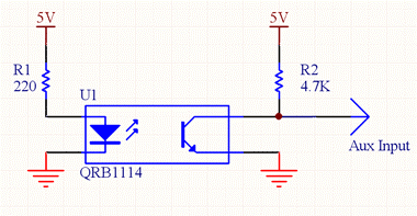

I am trying to get a tachometer connected via a 7i76. Anyone have any idea what I am doing wrong?
I have an optical reflective tachometer that I built using the circuit below except that I used a OPB704WZ sensor instead of the QRB1114. This unit works on my DRO. I thought that it might work if I connected it to encoder. I am thinking that there is probably something in the HAL or .INI that is not right but I don’t know what that might be.
TB3 - 9 Ground
TB3 - 12 +5 volts (4.91 measured)
TB3 - 13 Index+ (Aux Input on diagram)
Jumpers W4,W4, & W6 are in the left hand position for TTL single ended input.

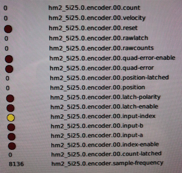

This is what the HAL watch shows when the spindle is running.

Does the hm2_5i25.0.input-index toggle when you rotate the spindle?
If not, what are the voltage levels on the AUX pin for both sensor states?

No, hm2_5i25.0.input-index does not toggle.
4.65 and 2.11 volts
4.65 and 2.11 volts

Right, so that is not going to work because the low level (2.11 V) is not a valid TTL low level
Part of the problem is that the 7I76 input has a 2K pullup so the pullup current is higher than expected
things to try:
1. Remove the 4.7K pullup
2. increase the LED current (its ~15 mA with the 220 Ohm resistor) you could safely double it to 30 mA or so
with a 100 Ohm resistor.
3. Make sure the optical target distance/angle is correct (adjust while reading the low state voltage)
things to try:

I made another sensor with the changes PCW recommended and the hm2_5i25.0.input-index pin now toggles when I rotate the spindle. Now to get this hooked to the display and fed into the PID to make sure the commanded speed is achieved.

Just a follow up to this PCW. I did get this all working with you suggestions. I dropped the 4.7K resistor and replaced the 220 ohm with a 100 ohm. Works great now.
