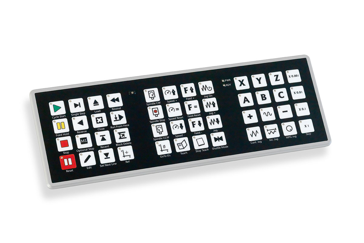

Hello all,
I am building my control panel layout and started adding tons of buttons and it started looking confusing and more like an arcade game rather than a cnc control panel. I was searching for some ideas and ran across the Pokeys Keyboard which is designed i think for Mach3 specifically, but was curious if anyone had used it with LinuxCNC? here is a link to the product page, its a very sweet setup, nice and compact with good intuitive descriptions for the buttons with drawings and very easily packageable on a control panel face. just figured if this could be made to work it is well worth the price of parts as my button tally is getting quite expensive as it is and the wiring that will be required will be mind numbing it feels like.
Any thoughts?
www.poscope.com/product/ponet-kbd48cnc/
Any thoughts?

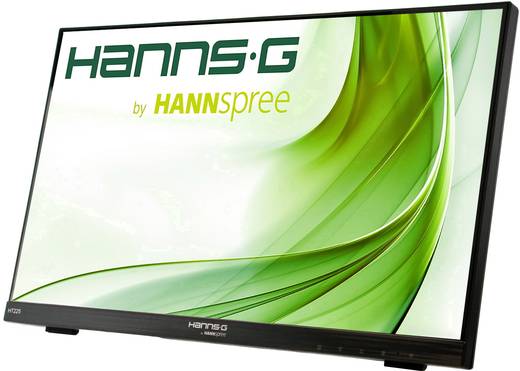

Hmm,
It's quite expensive in relation to touchscreen ....
I ordered this touch screen for 255 euro, little expensiver then 169 euro. But i did not get it working on linuxcnc tonight.
I think a touch screen will not be like an arcade game. It will take the machine to the next level.
This is a hanns-g-ht225hpb-touchscreen-monitor and the colors are very good. I only need a way to get the usb touch mode
activated.
activated.

Hi, Lcvette,
I used this keyboard a couple of years ago with the Pokeys56E and I controlled it through Modbus TCP, I am very cool since you can handle the buttons and the lights separately, although the keyboard finish is very good I do not advise it for an industrial type workshop, I hope I have helped you.
regards
Chimeno
regards
Chimeno

@Touch screen update.
The Hanssg touchscreen Euro 255,-- is working on linuxcnc now finally.
I have installed ubuntu forwarding this great example : Kurt Jacobson installing touch screens
After normal install, the touch screen works.
After installing rt kernel, touch screen don't work.
So problem to solve :
copy and past in terminal : sudo gedit /etc/modules
Okey now add this to the text file :
Okey then save and close the text file.
Copy and paste in the same terminal for activating touchscreen : sudo modprobe hid_multitouch
Touch screen is working.
Okey i think keyboard and mouse within machine cabinet is handy.
I think also for embedded system's touchscreen can do a great job. Think about automated band saw project's or
special custom made application's. So that's why i wanted the touch screen application working.
Toggle line numbers
1 # /etc/modules: kernel modules to load at boot time.
2 #
3 # This file contains the names of kernel modules that should be loaded
4 # at boot time, one per line. Lines beginning with "#" are ignored.
5 # grotius added 27-2-2018 "hid_multitouch"
6 loop
7 lp
8 hid_multitouch
9 usbhid
10 rtcOkey then save and close the text file.
Last edit: 27 Feb 2018 00:47 by Grotius.
05 Mar 2018 13:05 #106950
I quite like the "Touchy" interface. It expects a single jogwheel and 4 physical buttons. The on-screen controls decide what the jogwheel does (from jogging to scrolling through the G-code listing) and you need to press a physical button to start the cycle. (which I like, not entirely trusting touchscreens).
The PoKeys keyboard can possibly be made to work with LinuxCNC, but not into the realtime layer (Because USB HID passes through the userspace layer). Note that it needs a PoKeys device to connect to, it isn't itself USB or hard-wired.
It is hard to see what the interface is on these:
www.ebay.co.uk/itm/For-FANUC-Membrane-Op...g-Jia01/291675428459
But if the individual wires are available as a matrix keyboard then the Mesa 7i73 (equivalent to a PoKeys56) could be used to link it to LinuxCNC and that _does_ communicate straight in to the realtime layer.
Of course the 7i73 is only an option if you are building a mesa-based machine.
Replied by andypugh on topic Pokeys Membrane CNC Keyboard and LinuxCNC?
I also have a 22" high quality ELO touch screen but have never tried using them before so I am not sure what i'm in for. I suspect I will try it out with minimal buttons and then see what I find would be useful to have and what the touchscreen and keyboard are perfectly ok for.
