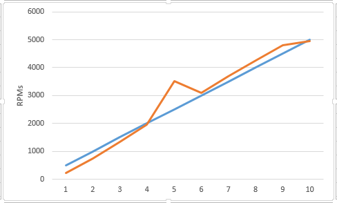

Hi Folks,
Well I am at that point where I have the spindle speed somewhat controlled by LinuxCNC. I have a 7i76 connected to a Sieg X3 mill which uses a 0-10v control. I have a reflective sensor on the spindle for the encoder feed back. I followed PCW's advice and removed the resistor from the wiper connection (TB4-2) and got the spindle enable connected to the XMT control board in the X3 and that is now working. I have been playing with the spindle parameters and testing. Below are the commanded RPMs / Actual RPMs / Voltage at each 500 RPM increment. This data was gathered with the PID turned off.
Next I turned the PID on and did some testing. At 2000~3000 RPM it will hold the speed really well for about 20 seconds then its as if the power drops out for a spit second. At startup If I command it to go 2000 or 3000 it will overshoot by 800~1000 then drop below and the come back up to speed. It does all this in about 2 to 4 seconds. At 1000 RPMs commanded its is as if the speed control is constantly being blipped every couple of seconds.
At this point I think if I could just remap the commanded speed output given a desired speed I would be happy with that. I think lincurve is what I need but I haven't figured out how to use it yet. On the other hand it feels like I might be close to getting the PID to work which would be the best.
I picked up some controls from a guy on youtube that allow the PID values to be entered real-time rather than changing the .ini and restarting LinuxCNC but I haven't tried to install them yet.
CMD Actual Diff Volts V-Diff
500 234 266 0.98 0.98
1000 751 249 1.94 0.96
1500 1347 153 2.96 1.01
2000 1951 49 3.97 1.02
2500 3527 -1027 4.97 1.00
3000 3105 -105 6.00 1.03
3500 3678 -178 7.02 1.02
4000 4251 -251 8.05 1.03
4500 4808 -308 9.09 1.04
5000 4957 43 10.12 1.03
On this graph the blue line is the commanded RPM and the orange is the actual RPM.
Could I really be close to getting the PID to work? If so what should I try next?
Does anyone have an example of using lincure?
At some point I want to do rigid tapping but I'll need to add a spindle encoder for that. I am also considering replacing the motor with a servo motor and a belt drive.
Here are my .ini and .hal data.

06 Mar 2018 12:40 #107030
Replied by andypugh on topic Fighting the PID!
If the graph is accurate then PID will never be able to work. You have an area where more-command = less-speed. PID controllers are too dumb to cope with that, they need a monotonic (but not necessarily linear) response function.
Have you tested the output voltage of the electronic potentiometer (Be very, very, careful, you are measuring a difference of 10V on pins that might be 120V above GND)

06 Mar 2018 16:48 #107044
My question was whether the control voltage varied smoothly with speed command, or whether that kick in the graph corresponded to a control voltage quirk.

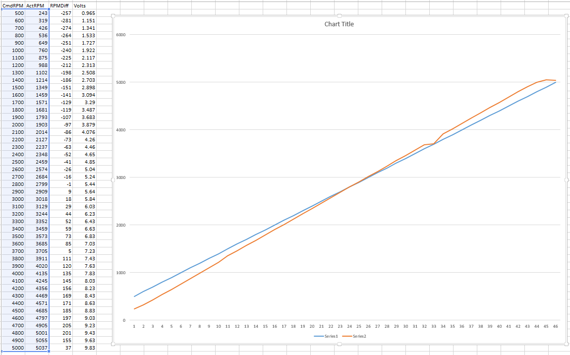

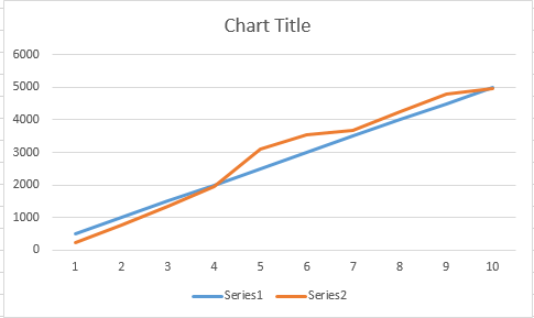

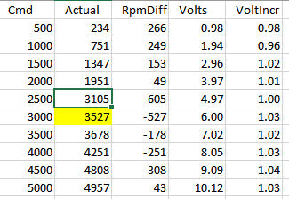

06 Mar 2018 18:27 #107051
by JohnnyCNC
Replied by JohnnyCNC on topic Fighting the PID!
I looked at the chart again and it looks like I likely transposed two of the Actual rpm readings when I entered them into the spreadsheet.
I think this is how the chart should have looked but I'll have to confirm when I get home. The suspect values are highlighted. There is still a bump but its not so big. I am also going to rerun the test in 100 rpm increments at least for the area of the bump 1500-3500.

06 Mar 2018 18:34 #107052
OK, either lincurve or PID ought to be able to cope with that.
I would probably use lincurve because spindle rpm isn't actually _that_ important.
It needs to be right, but "right" isn't something that you know as a number, but by result.
