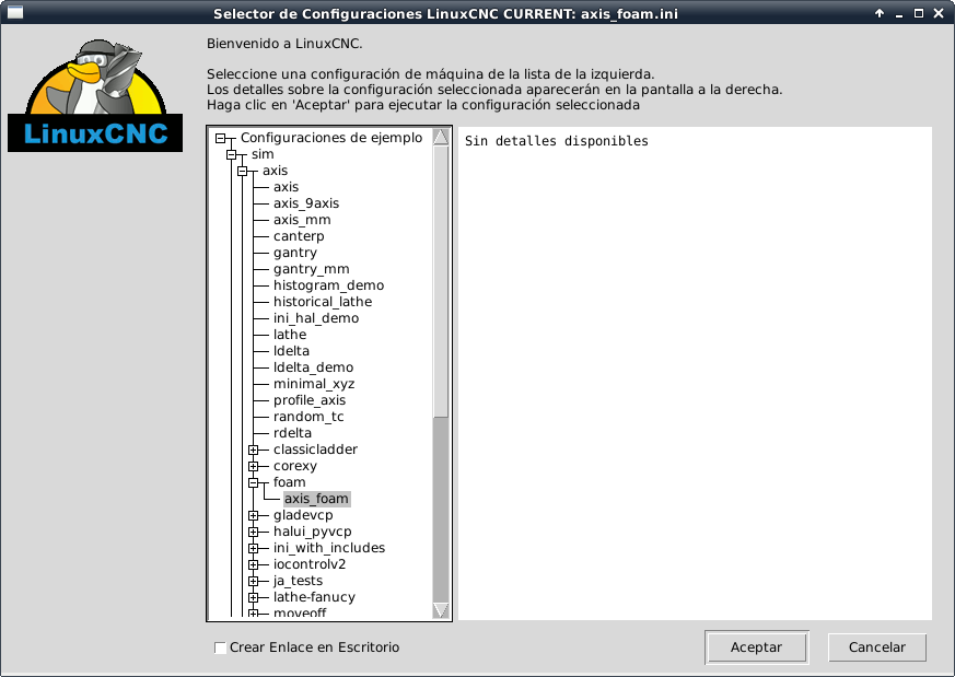

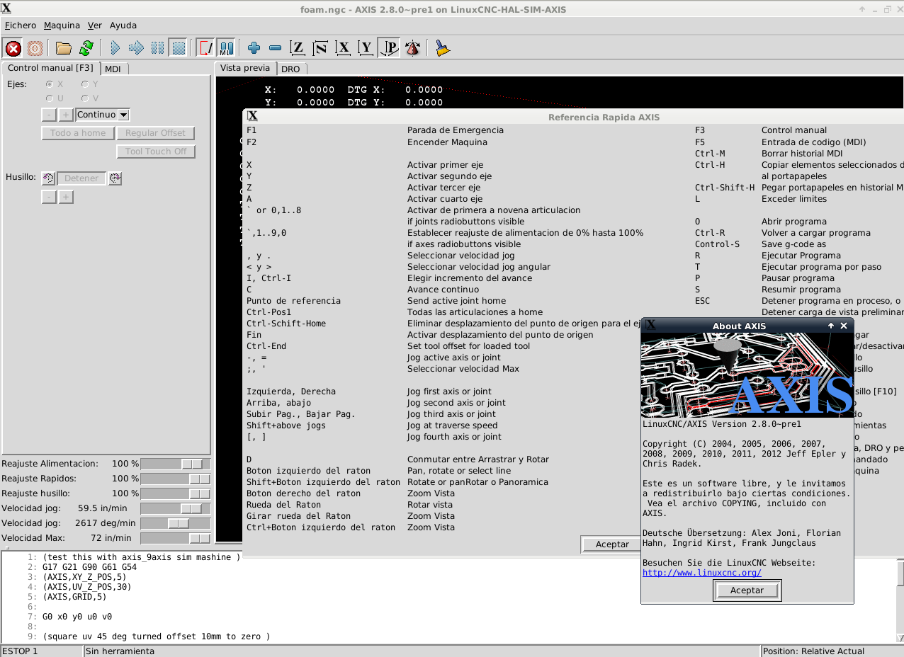

I have successfully downloaded and compiled the master branch from git. I have installed all the dependencies that I need and my RIP installation works correctly.
Now, the issue.
The current translation attempt (internationalization is a better word) of LinuxCNC to Spanish is just an "attempt". Horrible, incomplete, erroneous .......... and apparently abandoned. I want to solve that situation.
I'm using poedit, a .po file editor, and the "make" way. I already have more than 30% translated. Samples attached.
I have two doubts:
Should I follow the original keyboard shortcuts? In English, many words with a shortcut letter have no equivalent word (with the same letter) in Spanish.
Second. Are some text hard-coded?. For example, the instance of the word "CURRENT:" in Configuration Selector bar title, does not appear in my poedit list. What is the way to do it in this case? Report to developers? Rewrite sources and recompile? I don't know.
I think you might need to use the original shortcuts, as they are hard-coded:
github.com/LinuxCNC/linuxcnc/blob/master...cripts/axis.py#L2977
I have had a quick Google and didn't find if there was a way round this.
You can make the required changes and then make a pull-request on Github or email a patch file to the developers mailing list:
linuxcnc.org/docs/2.7/html/code/contribu...r_ways_to_contribute
You would need to do one of these things to submit your updated .po files anyway.
(But it would probably be best to keep them as two separate commits)
