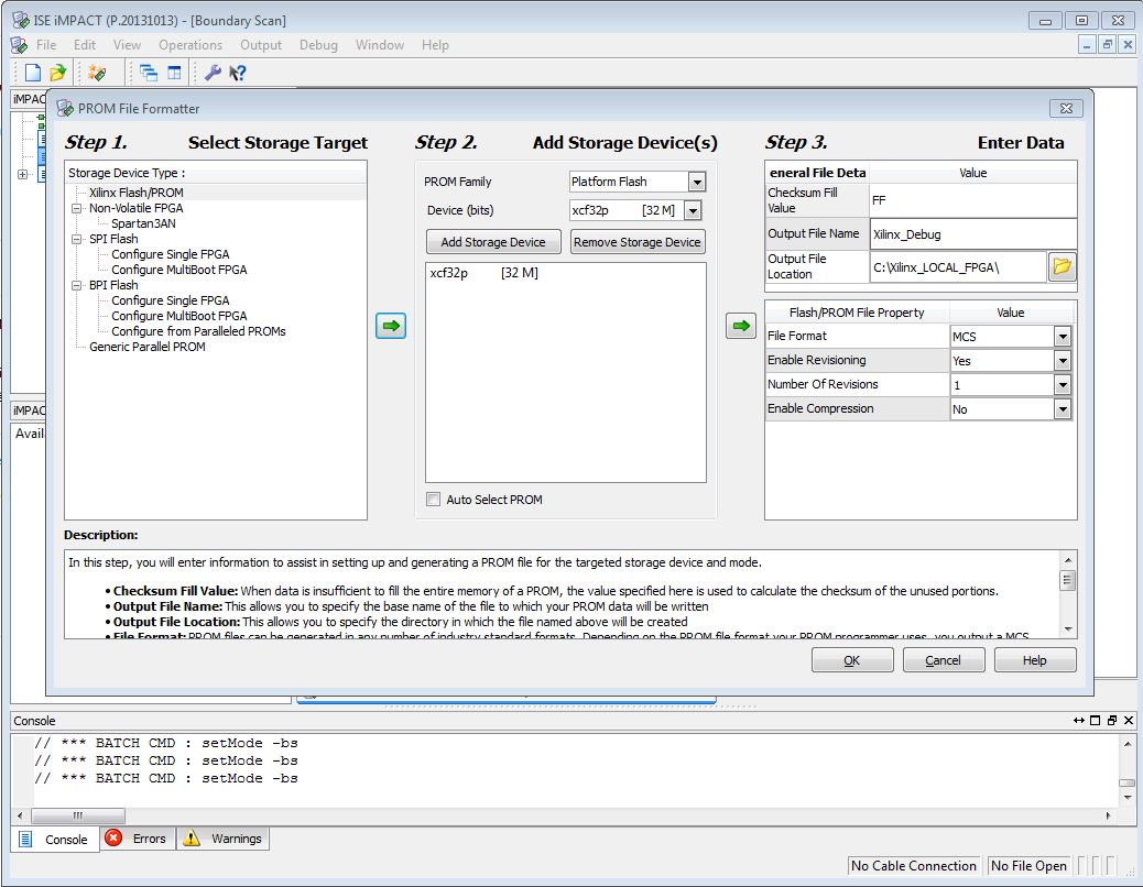

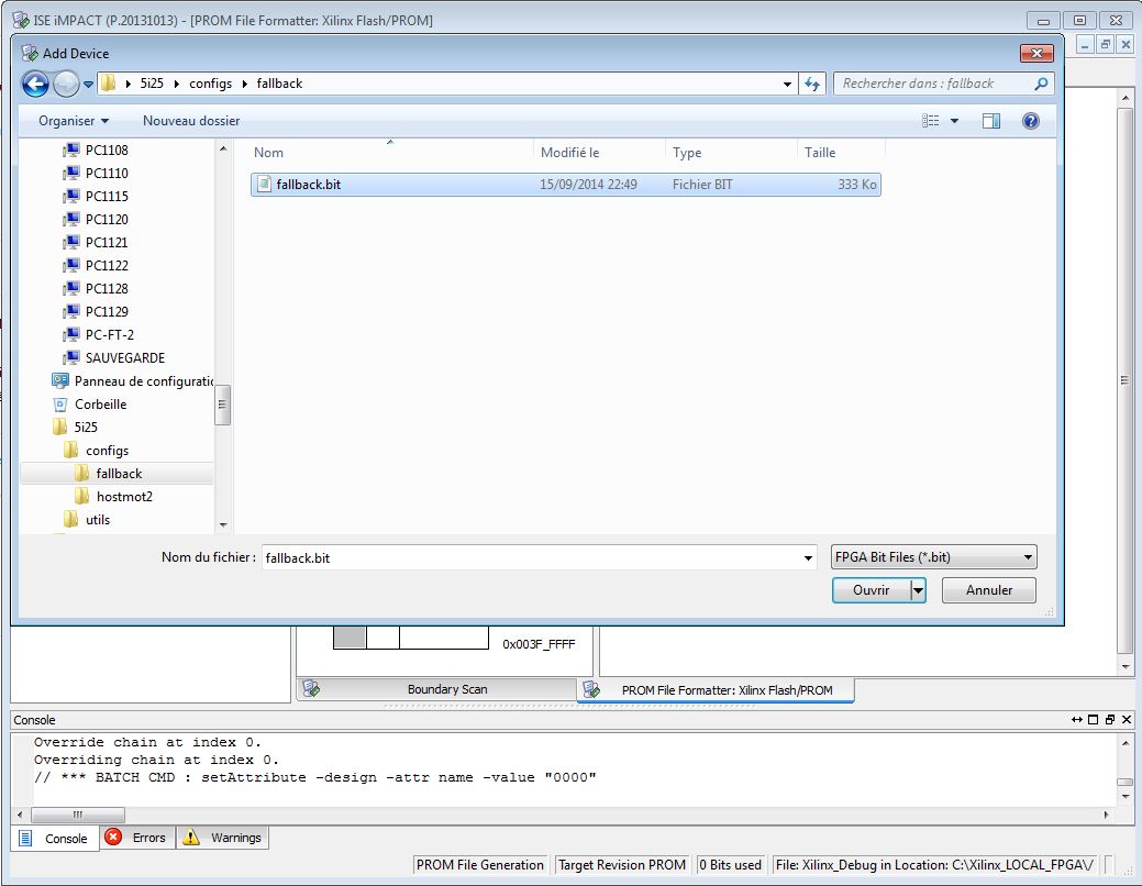

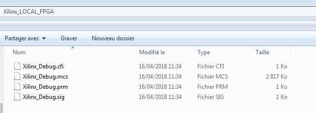

16 Apr 2018 09:48 - 16 Apr 2018 09:49 #109119
by CERTIA
Replied by CERTIA on topic PC doesn't boot after plug in 6i25 Mesa card
Hello PCW,
I generated a prom with IMPACT (attached screens). I don't know if I did it correctly... Can you tell me if a 4-pins JTAG is enough to debug the card or do I need a 6-pins cable? I tried to make a cable out of two (because I don't have any). I soldered the pins like:
USB 6I25
VCC TCK
Data- TDO
Data+ TDI
GND TMS
But it does not work, I think I need 6 pins but how do we solder the pins to the USB connector please?
Thanks in advance.
Certia
USB 6I25
VCC TCK
Data- TDO
Data+ TDI
GND TMS
Thanks in advance.
Certia
Last edit: 16 Apr 2018 09:49 by CERTIA.
- Posts: 18105
- Thank you received: 5328
16 Apr 2018 13:58 #109121
Replied by PCW on topic PC doesn't boot after plug in 6i25 Mesa card
Typically the power pin on the JTAG connector is used to set the
input and output voltage levels of the JTAG programming cable.
Its definitely needed for for the Xilinx cables I am familiar with

17 Apr 2018 08:45 #109174
by CERTIA
Ok, do you think that I can create a JTAG using only fours wires for TDI, TDO, GND and 3.3V? (It seems that there is some electronic between the FPGA connector to the USB one)
If not I will wait to receive a Diligent HS2 cable (is there another type of cable that would work as well?)
Finally, can you tell me if my screenshots are correct please? Else, what should I do ?
Thanks in advance PCW.
Certia
Certia
- Posts: 18105
17 Apr 2018 14:35 #109187
As far as I know you need all 6 wires for Xilinx and the JTAG cables I use.
Its possible you could get by with 5 wires (no 3.3V) on a JTAG cable that
had fixed output voltages (and that you setup for 3.3V signaling)
