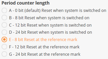

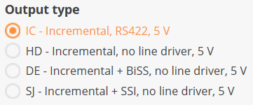

I need some help here guys. I've posted all of the info I have gathered below for reference I’m working on upgrading the motor on my mill using the DMM DYN4 1800 watt servo motor. I am also going to switch to a belt drive with a 1:1.8 ratio (motor:spindle). Based on the motor rated speed (1500) and max speed(3000) I will have a max spindle speed of 5400rpm with 1.34 HP at the spindle What I’m struggling with is figuring out how to get an encoder signal to do rigid tapping. I THINK the options I have are to use the quadrature output of the servo and use the optical sensor I currently have on the spindle as the index pulse. This is a cheaper option but may not be a good option. The other option would be to use a product from RLS (www.rls.si/eng/products/rotary-magnetic-...adial-magnetic-rings) which is a magnetic ring that I can mount on the spindle and mount the read head next to it. The problem is they ask questions in their configurator that I’m not sure how to answer. Below you will see the options in the configurator with my guess choices selected. I thought about contacting their support but I’m not sure I would have the answers to the questions they might have about the requirements/capabilities of the 7i76 or LinuxCNC. Based on the Mesa manual I see that I cannot use count rate greater than 10 Mhz and I assume that would be cpr x rpm, or would it be ppr x rpm. The four options that I am really struggling with are Output Type, Period Counter Length, Interpolation, and Minimum Edge Separation.

03 Apr 2018 11:57 #108295
Replied by andypugh on topic Spindle servo motor conversion with encoder questions
Just use the existing opto for index and scale the spindle position feedback to account for the belt ratio. It will work fine and save you expense and trouble.

04 Apr 2018 02:35 #108351
by JohnnyCNC
Replied by JohnnyCNC on topic Spindle servo motor conversion with encoder questions
Thanks Andy. I'll go that route. I can always add the encoder later if I ever have a reason to.
