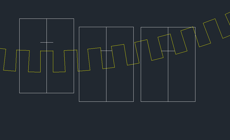

I have a lathe I am upgrading from Mach3 to linuxcnc. At present it has 1 opto spindle signal/pulse. I am obviously going to add at least on more, for threading do I need 2 or 3?
My segmented wheel looks like this (its not mine but the wheel is exactly the same)
I was looking at this diagram for a 3 opto setup and noticed that the opto's A and B are offset from each other - is this a software setting in LinuxCNC or do i have to achieve this through electronics connected to the Opto?
Any help appreciated

As you have the disk you need to separate A and B optos 90° as in picture. So only A or B need to be mechanically placed so you get this pulse separation. Do you have the CAD file for the disk? If not draw it and play around for A / B placement.
Cheers
Bengt

When you say 90 degrees? The left side of my picture shows A being fully off or 0 and B being fully on or 1, yet the waveform picture seems to have A as fully off or 0 and then B as at the very leading edge of on or 1....
Once I start fiddling with this is there any way to verify they sensors are in the correct spot?
thanks again

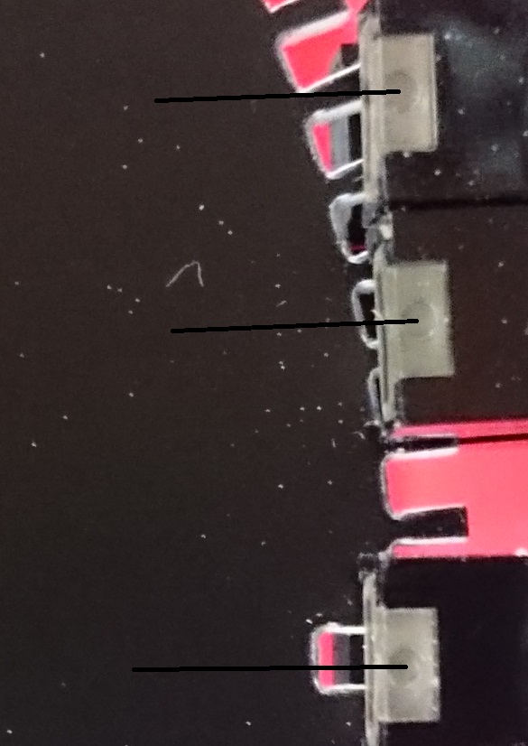

Why not try using CAD to get you mechanical positions för A and B, look at my 2:nd picture.
Cheers
Bengt
Cheers
Bengt

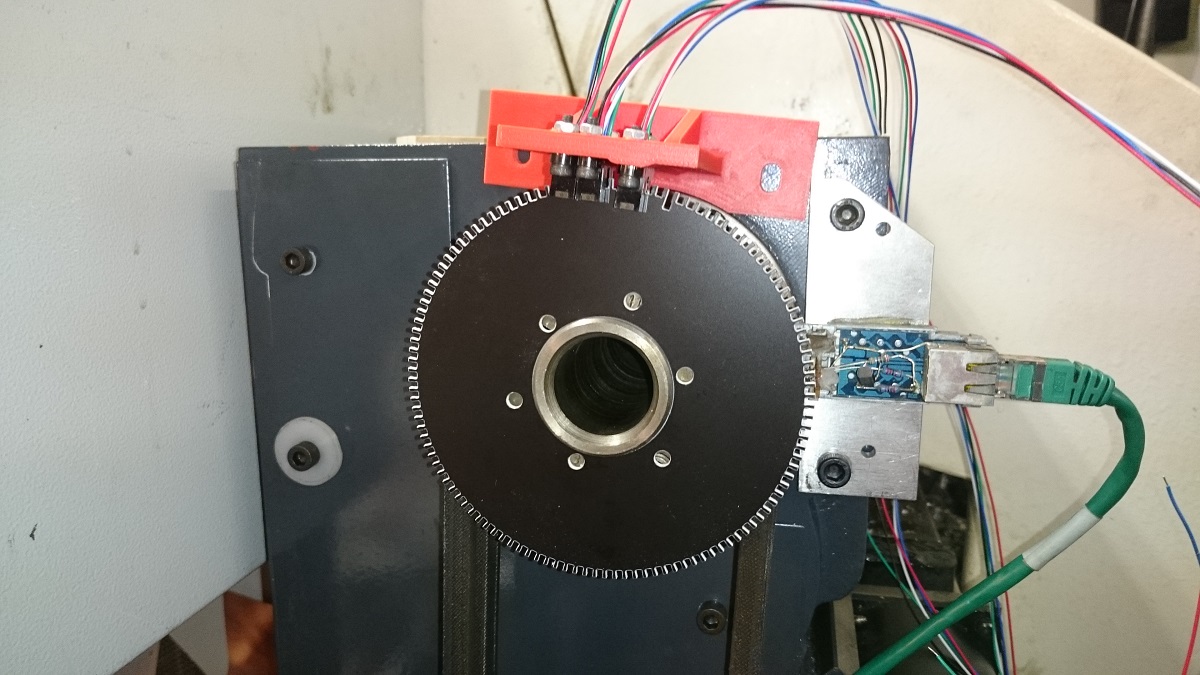

Hi Bengt, thanks again fo the reply. Sorry to be a pain, but I am new Linuxcnc and the spindle encoder is the part I was worried about when upgrading from Mach3.
In your last picture you have posted a cad diagram with the A and B pulse being binary opposite to each other e.g A being 0 and B being 1. I would have expected the pulse diagram to look like this:
Whereas the pulse picture I posted shows A as 0 and B as on the leading edge of 1.
I would then expect the cad drawing (borrowed your drawing I hope you don't mind) to show the B location to be on the red line.
In effect your picture A and B seem to be 180degrees out of phase with each other rather than 90degress.
Obviously 90degrees out of phase would make positioning the sensors quite difficult, but positioning them in a binary opposite fashion as you have would be a lot easier. However I notice you have tested this and it seems to work OK with linuxcnc?
Also what setting did you use for this configuration?
Again thanks for taking the time to reply - any assistance is greatly appreciated.
Steve
Steve
