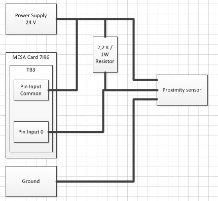

Hello
I have the same kind of question.
I want to add home sensor NPN on a mesa card (the 7i96)
I was wondering if this kind of wirring will fit ? (Cf picture included)
If yes what do you recommand to add the control to linuxcnc ?
restart the conf with the GUI (but I had to select the 7i76 card and to change by hand after the name inside the hal file...)
Or just add some lines in the hal file ?

www.mesanet.com/pdf/parallel/7i96man.pdf
Page 14
If you connect 24V to input common then you are configured for sourcing inputs and you don't need the resistor. A NPN prox functions as a switch-to-ground and that is what is needed to drive the inputs in the configuration that you have illustrated.

To further clarify, if you were to connect the ground to the common instead to configure the input as a sinking input. That is when you would need to use a pull up resistor like you have in your drawing.

Thanks for reply
So I will do the wirring without the resistor.
For the driver did you recommand to use the developpement branch of linuxCnc ?
Is it enough stable, I am not an expert
If not is there another way to configure the homming ?
