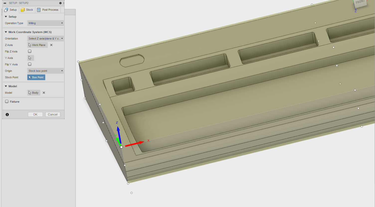

Hi thanks for the reply, I'm using 3d adaptive pocketing and then a parallel finish. I noticed today when I touch off, the G54 coordinates for X&Y set to 0 but the Z does not change is this something to do with how I have the tool setup?
Do the G54 Z coordinates have to read 0 if the tool is at the top of the material and I set the top of the material as 0?

in fusion,you need to check what you have part zero, stock box or stock body.. or osmething else.. and you need to know what you want to set to on the machine, stock or model.
as this will effect where part zero is refferenced from.
if you want to touch off to part 0 with a known set tool..that has already been measured(known length)
make the tool you want to use active and in the spindle..
you will need to G43 the tool length on.
then toch on the surface and touch off the Z axis to 0
the dro should read the 0
you can use a known setting length block and do the same by bring the tool slowly into contact & entering in its distance
the DRO will show the distance above stock by the setting block hight.
hope it helps..
hope it helps..
