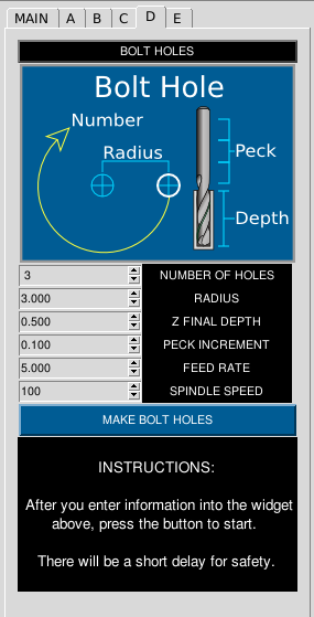

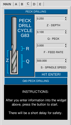

I have create a new control panel (don't I always?) which has an LED graphic assigned to pyvcp.goin-home that I would love to send data from my G-Code to the panel. (Look at the SAFE GO HOME button near the bottom.)
I have sent data FROM my panel into G-Code.... I have that process down pat... no problem.
For example, my PECK DRILL routine has lines to pull the depth to drill, etc...
So I thought that in my G-Code I could do something likeAnd it would pass the BIT value "1" to light up the LED... then later send...To turn it off.
So what am I missing???
pyvcp ==> G-Code = No Problem
G-Code ==> pyvcp = Problem
From G-Code use WHAT??? to make pyvcp.goin-home either a 1 or 0.
Can it be done? If so... I can have indicators on screen to inform the operator of various things.
