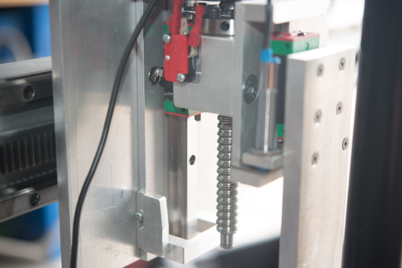

Quick question... does one typically place one limit + home switch on the z axis or 2? One would make sense or am I not understanding this properly?
- Posts: 12156
- Thank you received: 4149
30 Apr 2018 00:01 - 30 Apr 2018 00:03 #109837

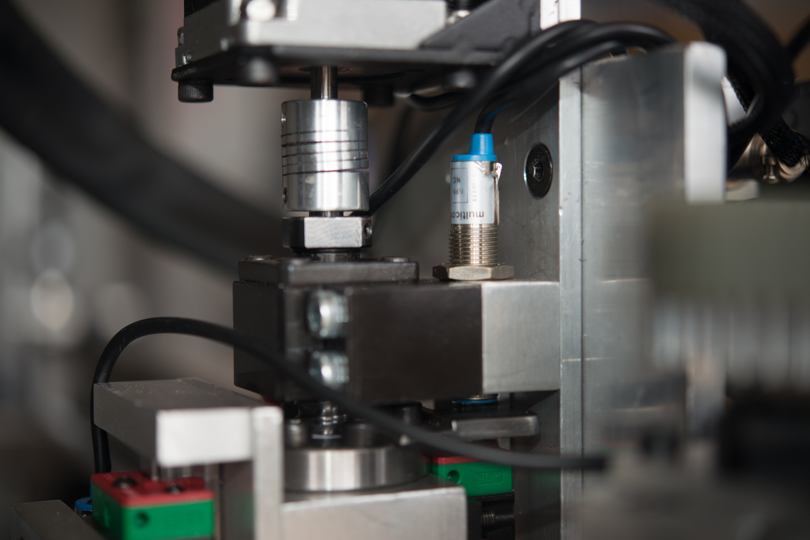

Depends on your machine but this is how I did it on my plamsa machine. Its a shared home/limit switch.
On the lower limit, I used a conventional micro switch because of space. I've been meaning to swap the switch and striker plate around so the wired component does not move.
I wanted to use prox switches becasue of the plasma grit but figured the lower limit would probably never get triggered so decided a mechanical switch would be OK there.
The Prox sensor in the second photo is for the floating head to sense the material.
Replied by rodw on topic How to prevent Z axis from homing? Seeking other advice
Last edit: 30 Apr 2018 00:03 by rodw.

Thanks so much for the input. I will figure out what will work best with that I have here. Space and mounting options decline rapidly on the z axis lol. This will be fun.
