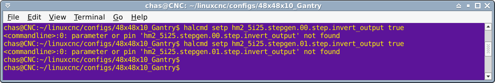

02 May 2018 17:08 #110040
by TRAUPMANN00
Replied by TRAUPMANN00 on topic Tandem X axis won't move
I was unsuccessful in implementing the commands to the computer as seen in image below.
(perhaps more training is involved??)
The value is set at FALSE with a voltage of 3.7V on both 00 and 01 axes.

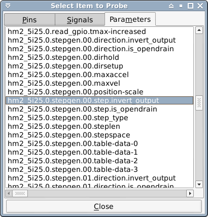

02 May 2018 17:22 #110042
Replied by PCW on topic Tandem X axis won't move
that's weird... can you try:
halcmd show param *step*
then copy/paste the proper step invert parameter name into the setp command?
