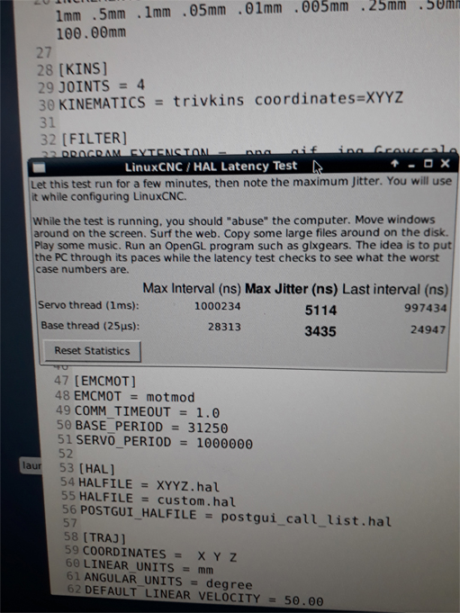

17 May 2018 10:32 - 17 May 2018 10:39 #110812 by denhen89
Thanks again very much PCW. You help me a lot with those explanations, but i hope its fine if i still have some questions.
1.
Yes jitter and latency are the same in this context, normally I think its suggested to set your base thread period to about 2 times the maximum latency so you should have a encoder sampling rate in the 50-60 KHz region.
So, i should have encoder sampling rate of 50-60 KHz, if i have an Max Jitter (ns) result of 5000-7000, correct?
If so, then there are some things i dont understand.
I went to my CNC router PC and checked again the Latency tests (without any glxgears running and without stressing the cpu) and also i checked what Base Thread Period is written in my .ini file. See the picture below:
What i now dont understand is, that when i did the stepconf, i wrote in the value 7000 at the first screen at "Base Period Maximum Jitter" where the standart value is 15000.
So, why in my .ini file stands 31250 at "BASE_PERIOD" ?
I hope you understand that this all is pretty confusing for me, but i really would like to understand it, even it might be a bit difficult for me :)
The next thing:
you can determine this frequency by calculating the inverse of the base thread period in your .ini file (1000000000 /base thread period)
By doing this calculation 1000000000 / 31250 (BASE_PERIOD value in the .ini) i get this result: 32000
I am not sure what i should think about it, but of course this value does not show me the KHz value, so i did something wrong.
I hope you are patient enough with me :D Of copurse i tryed to find any official explanation about that, but it seems there are no informations available about the calculation.
EDIT: Everything else you wrote is pretty informative, and i understand that if my latency is that low (5000-7000) i can use an 100 line encoder to RPM up to 3000 and for sure i will have no higher RPMs, due to the original spindle bearings which are in good condition and i dont plan to change them for now.
Last edit: 17 May 2018 10:39 by denhen89.
18 May 2018 21:59 #110857 by andypugh
Stepconf seems pretty conservative when choosing base thread rate. It might calculate it based on the actual step timing you need at max claimed speed.
It's easy enough to edit the INI and reduce the value.

18 May 2018 23:16 #110865 by andypugh
Now i am still wondering how the calculation of the spindle encoder sampling rate works.
You already did the calculation, you just chose not to believe the answer.
1000000000 / 31250 = 32kHz
If you use a 10,000 base thread then you get 100kHz
