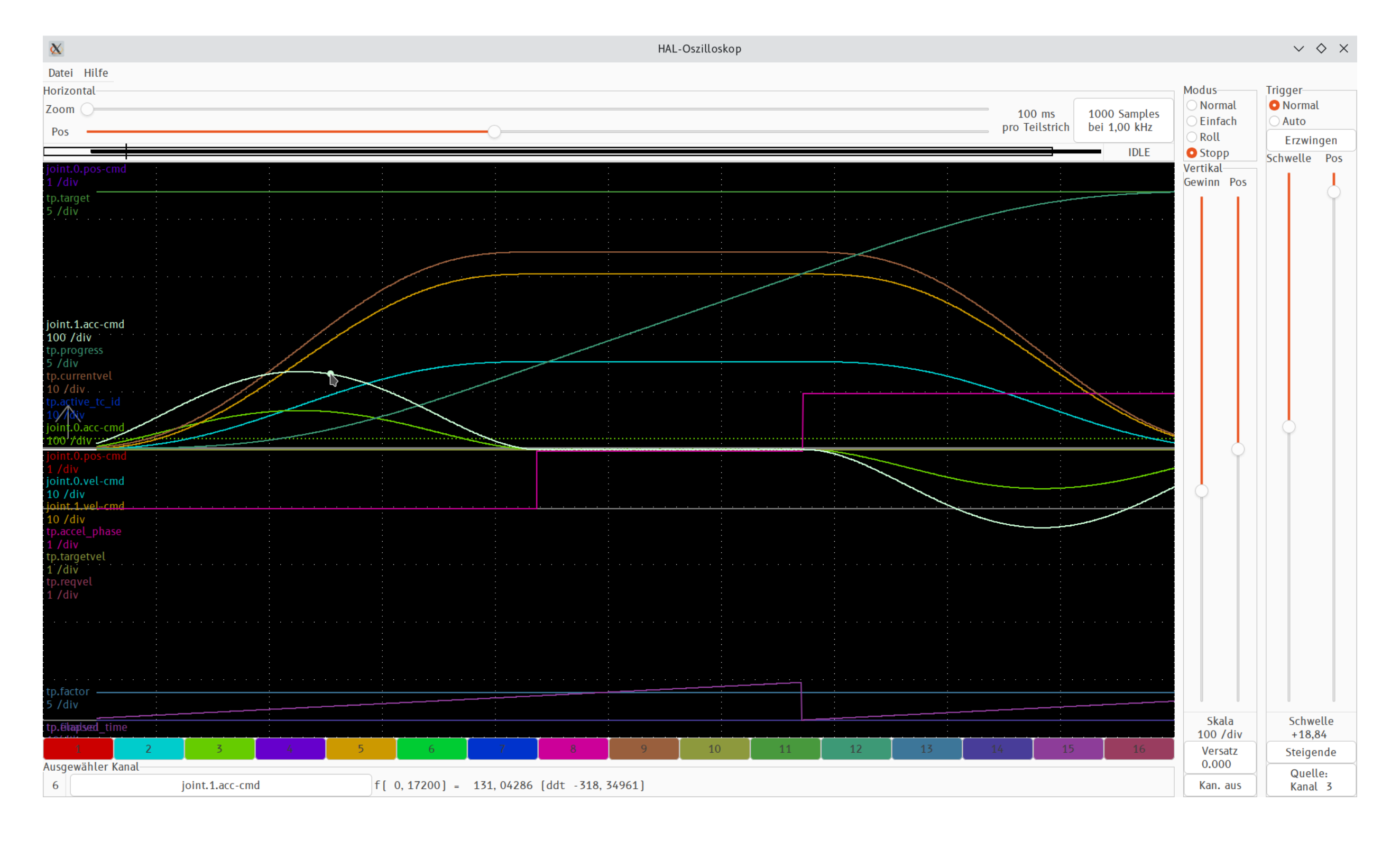

In theory, my code should not lead to acceleration excursions.
It may be a bug in the math (unlikely) or some interaction / wrong understanding of trajectory planner on my part (very likely).
19 Aug 2020 10:23 #178722 by Reinhard
Replied by Reinhard on topic c2 smooth velocity profile
The tinyG 6th order bezier curves inspired me to the code in the branch
g2 fork claims, that jerk-free acceleration works with feed overwrite and start/stop

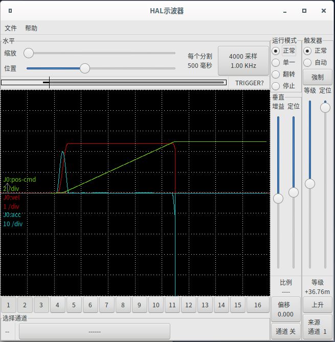

03 Apr 2023 20:39 #268222 by Zuo99
Replied by Zuo99 on topic c2 smooth velocity profile
Hello, rum, I recently tried to set the curve acceleration, I saw your post on the forum, and then found your code on Github, after downloading it, I compiled it and ran it, but it had some problems. I use the MID command and it starts off well, but ends up pretty bad with a steep drop in speed. I saw your result picture and it works great, I would like to ask what command mode you were using, how far you moved it, speed settings and such, thank you very much.
The picture below is my result, thanks again.

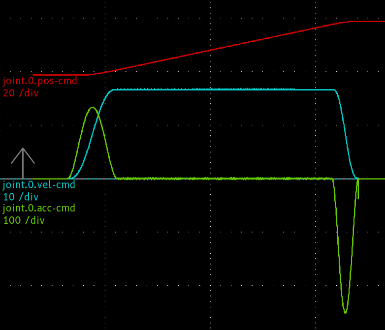

04 Apr 2023 09:07 - 04 Apr 2023 14:18 #268266 by rmu
Replied by rmu on topic c2 smooth velocity profile
In case this is addressed to me: I don't remember exact commands, but it was some short G0 or G1 move. The code obviously has some problems.
edit: added a screenshot of rebase on 2.9, g1 move with distance 20, feedrate 1000, metric.
Last edit: 04 Apr 2023 14:18 by rmu.
