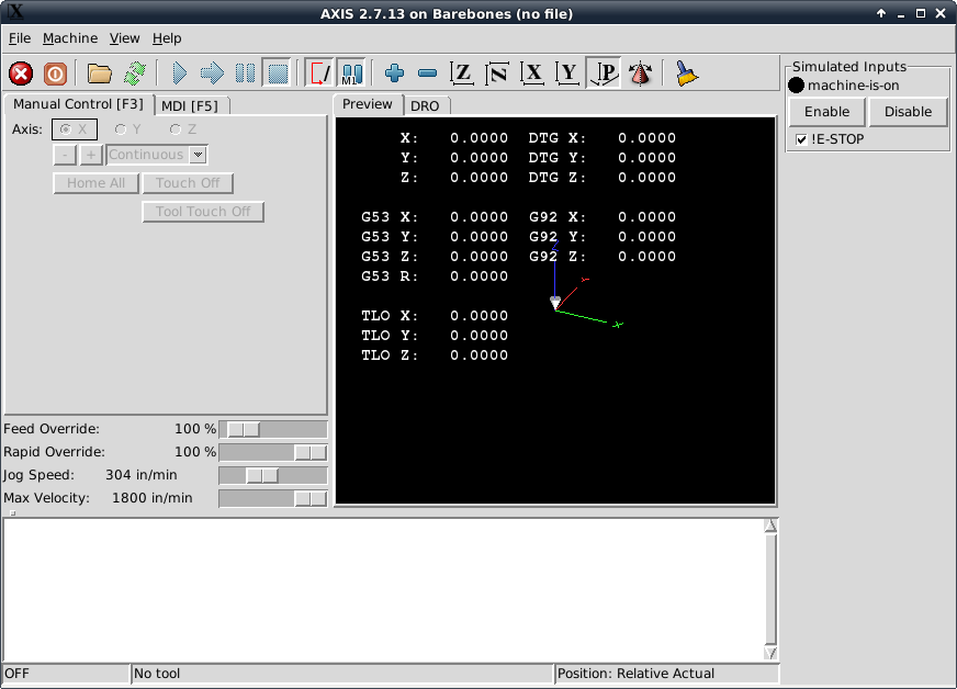

The "Toggle Machine Power" button still remains something of a mystery to me. I can cause it to be activated but can't prevent it from being deactivated.
I'm close to a solution simulating three external buttons I'd have on the system anyway. Here are my expectations and observationis:
* AXIS starts up and shows e-stop button state relative to external e-stop
--> Works as expected
* Pressing external "Enable" or "Disable" do nothing while e-stop is active
* User cannot press "Toggle Machine Power" button
--> Working, but not quite how I'd like. It displays message "can't enable motion, enable input is false". I'd prefer no message or something like "Use button on control panel to enable machine".
* User presses external "Enable" button and there's a delay (signaled by flashing indicator) before enabling motion. During this time no user-initiated motion is allowed.
--> Also seems to be working. Homing buttons and menu options are greyed out, arrow keys do not cause motion, also program run/step/stop controls are all greyed out
* Pressing "Enable" again does nothing when already enabled
* Pressing external e-stop disables machine, setting UI buttons to correct state
--> Works, but I'd rather not have the cryptic message "motion stopped by enable input" appear at bottom-right of screen
* UI e-stop should be a slave to external e-stop
--> e-stop cannot be cleared through UI but it can be set. This is acceptable, but custom delayed enable is broken by this action until "Disable" is pressed
* "Toggle Machine Power" should not do anything, being a slave to the custom "Enabled" state
--> Pressing "Toggle Machine Power" results in similar undesirable behaviour to pressing the UI e-stop
See attached config. It should work without custom hardware.
