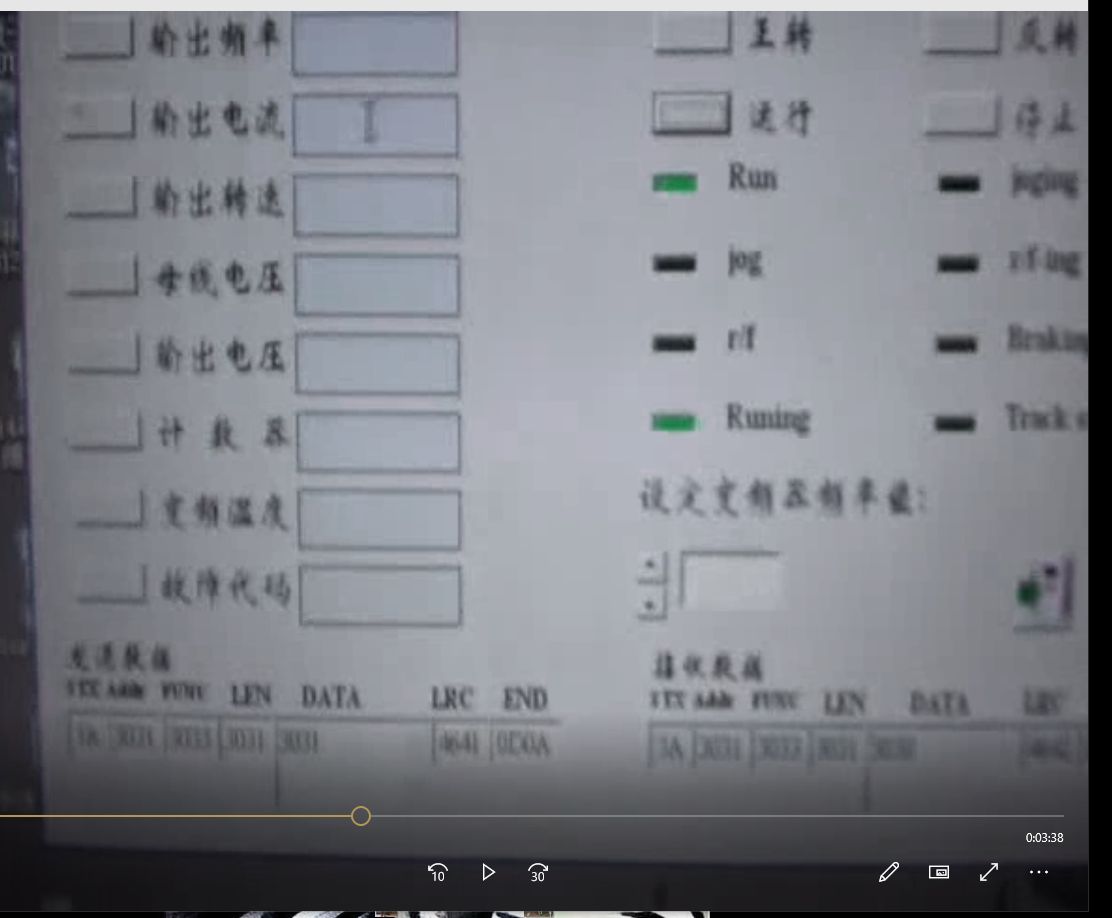

05 Jul 2018 17:21 #113482 by TRAUPMANN00
I am attempting to work with people in China to resolve my VFD issue. They sent a video that showed the use of some software that could test the communication between the computer and the VFD. I am not able to send the video through this Forum, but I have put it on Google Drive for viewing. You can access it through this link for the next 30 days.
drive.google.com/file/d/1-fgPxOtMKleV74i...RTP/view?usp=sharing
If someone who speaks Chinese you may be able to listen and find out what this software is:
I would like to find similar software for use on a Debian system.
I do not have a PC near the VFD, nor 220V near my PC.
Please let me know.
05 Jul 2018 19:48 #113502 by rodw
Software is sscom32.
Try this download link
en.tzonedigital.cn/en/tools/details/10.aspx
There are a number of modbus simulators that turn up on a google search.

06 Jul 2018 18:01 - 07 Jul 2018 19:08 #113593 by TRAUPMANN00
loaded on an old XP laptop. It worked.
What commands do I send it??
Checked out numerous softwares and none are easy enough for me to manage ;-(

07 Jul 2018 22:15 #113730 by curtisa
How about SpindleTalker2 ? That seems to be a popular little application used to give you a go/no-go chekup on the Huanyang VFDs on Windows.
