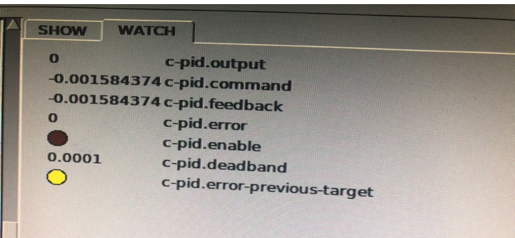

i face strange issue
when i enable my c axis it shows pid error between 1 to 9 any value and it is different every time when i enable
i ahhached image for c pid when enabled and when not enabled
now issue is i can see this pid error value all time but same time command and feedback is ok it is almost similar
so why it shows pid error
can anyone help me for this

Replied by PCW on topic PID error
A PID error is expected anytime the PID is enabled,
what is important is the size of the error
( the error you show is only .0000206)

26 Jun 2018 13:18 #112887
I think you might be mis-reading the number.
2.062E-5 = 0.00002062
9.9999E-10 = 0.000000000999999
So if the error is very small it will _always_ begin with a number between 1 and 9.
Replied by andypugh on topic PID error
But error show more then 2,0 to 9
