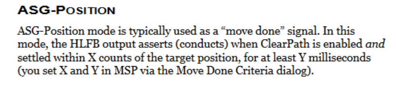

Hello I have integrated motors that give a "move done" confirmation (5V+ continuous) after each completed step. There is a positive signal that gets sent from the motors on one wire and a negative wire also from the motor to receive it?or ground?, meaning there would be 2 IO pins used? am trying to figure out where to hook them up on a MESA 7i76e, and how to integrate the "move done" signal into linuxcnc.

Hardware wise you would wire HLFB+ to 7I76E field power (typically +12 or +24VDC)
and HLFB- to a 7I76E field input.
Not sure "move done" is of much use to LinuxCNC, it might be better to program HLFB as a drive fault signal

Thanks for your response. The hlfb can handle 5-24v but I think I will have to ask the manufacturer if that will effect the voltage of the integrated circuitry adding to step/dir signals. How would I setup a (if drive fault feed hold) in linuxcnc on an input pin?
are you sure? about "move done" signals? I saw a few people using brush-less dc servos on linuxcnc with encoders and I thought those needed to confirm success of each move.

The HLFB signal is completely isolated from the step/dir signals so there no interference between them.
Typically the drive fault would be wired to axis.N.amp-fault-in in hal and will cause a machine fault if asserted.
Systems with encoder feedback to LinuxCNC "confirm success" by monitoring the difference between the commanded position (from LinuxCNC) and the actual position (from the encoder). If the difference between these exceeds a pre-programmed limit, a fault is raised.
