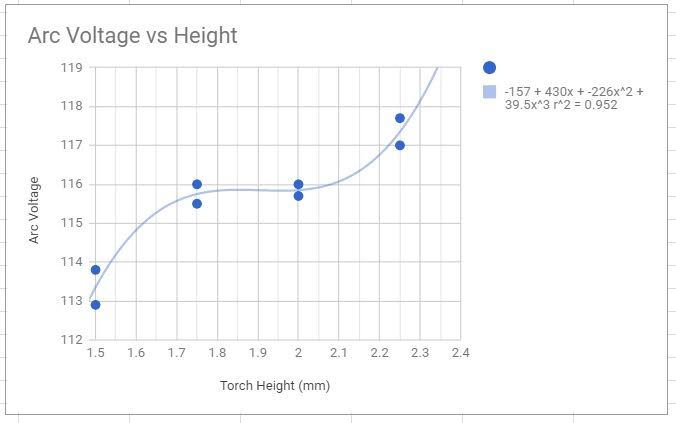

06 Jul 2018 22:27 - 06 Jul 2018 22:30 #113611
I don't think the work I did contained config errors
The eoffset-pid component Dewey wrote is a HAL Lib component that the user does not touch it or its connections
github.com/LinuxCNC/linuxcnc/blob/dgarr/...nts/eoffset_pid.comp
The config I was using was based on Deweys. hpid_mm.ini sim
github.com/LinuxCNC/linuxcnc/tree/dgarr/..._offsets/eoffset_pid
All my setup was in accordance with the documentation Dewey wrote.
I think its more of a case that we don't fully understand torch voltage behaviour and also from what Islander261 has done indicated that any additional filtering of torch voltage whether it is done in hardware or software, introduces delays into the signal which caused tracking problems for him. He spent a lot of effort optimising his physical plasma environment to achieve maximum signal response..
Its always been assumed that there is a linear relationship between torch height and voltage. One test I did with a very limited data set indicated that the torch voltage was a 3rd order polynomial as this graph shows with a 95% confidence level
The next step is to use halsampler to collect a much bigger dataset with a gcode program that initially probes the test area to account for surface irregularities and then does a single cut at varying height over about 150mm. Then load the cut data and the probe data into a spreadsheet, adjust Z height with probe data and repeat the regression analysis with a few thousand data points and see if the trend is confirmed.
So with this graph, applying a deadband around the plateau makes sense.
If the plateau is confirmed, it will be a good way to determine ideal cut height on a given material with a single cut as it will be in the centre of the plateau.
So that is todays' task if nothing goes wrong.

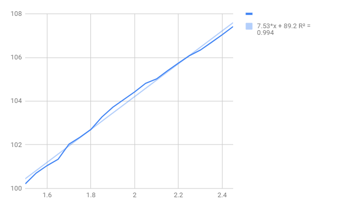

07 Jul 2018 08:56 #113649
Replied by rodw on topic FPGA (field programmable gate array) programmed for linuxcnc motion
Well, it seems I shot my earlier theory down in flames. I used Halsampler to capture about 9200 readings and plotted the results. (Torch height in mm vs torch voltage.)
You can see the torch voltage is linear across a large height range. But at least I know that my plasma cutter changes at the rate of 7.53 volts per mm. There are about 450 readings per reading in 0.05mm increments from 1.5mm to 2.45mm

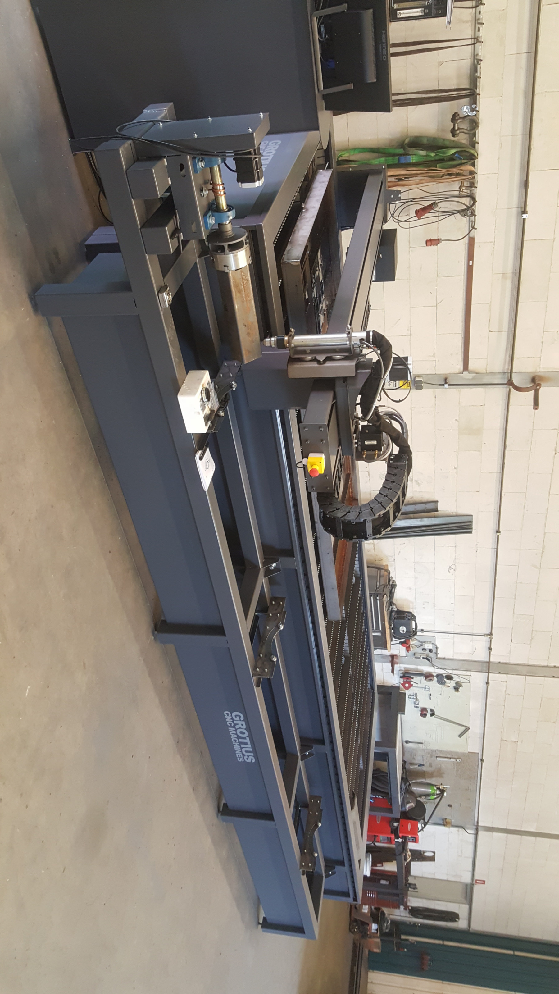

10 Jul 2018 20:14 - 10 Jul 2018 20:45 #113967
by Grotius
Replied by Grotius on topic FPGA (field programmable gate array) programmed for linuxcnc motion

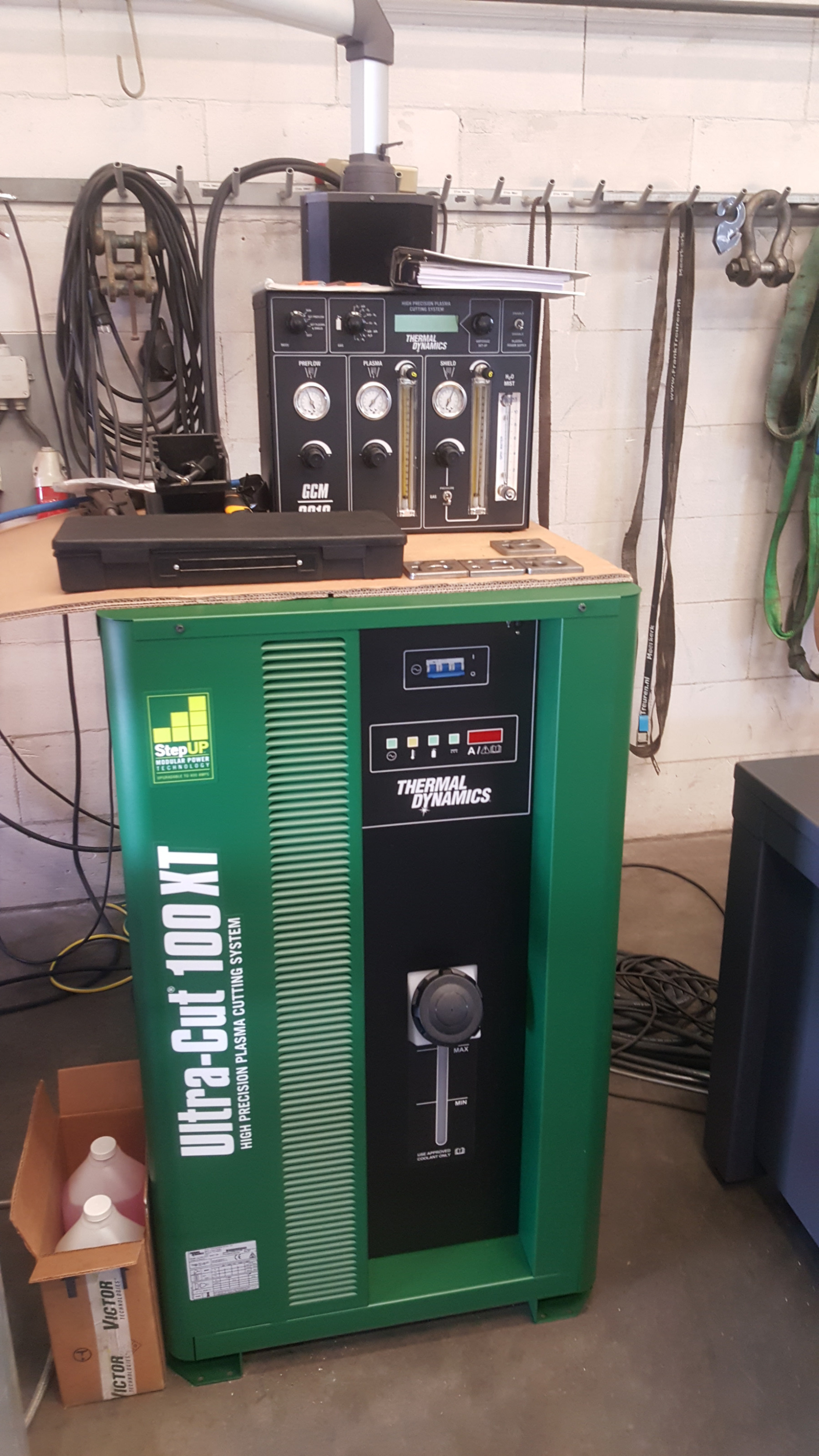

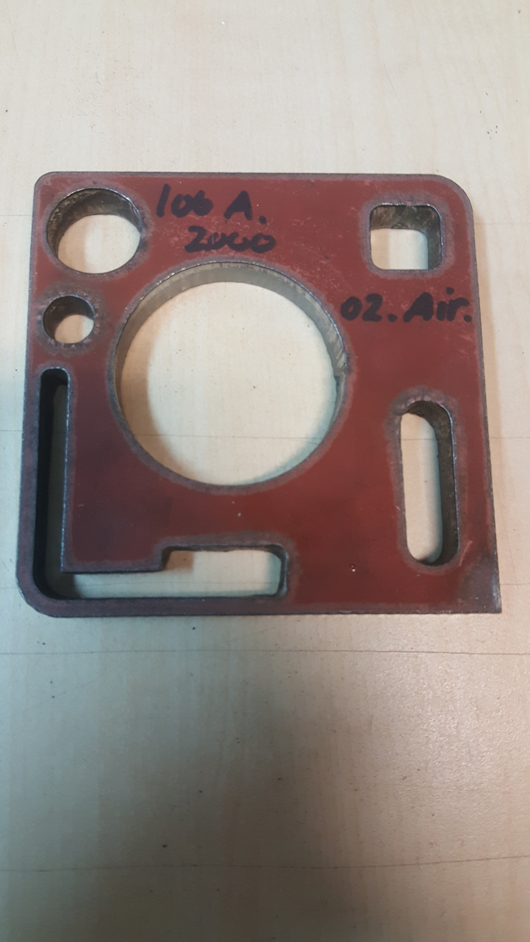

This is what i get on a 10mm mild steel plate with linuxcnc. The tiny hole is 10mm. The plate is cut at 100x100mm.
Plasma source : Thermal Dynamics ultracut 100xt
Material : mild steel 10mm
Speed 2000 mm/min
Power 100 amp
Cutting gas : Oxygen
Shield : Compressed air
Cutting angle : less 1 degrees
This is the test machine with the linuxcnc hard disk. Accuracy machine 0.1mm in movement, stepper + 2x ltp1 machine.
Okey now turn your monitor 90 degrees
Okey now turn your monitor back in orginal direction.
Plasma inverter :
