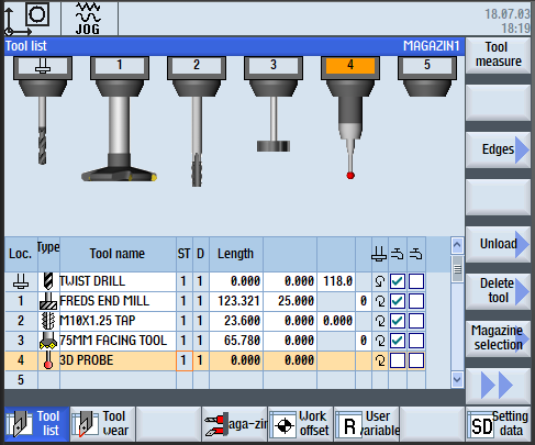

Thanks for your help. I was hoping to be able to use just the one tool file, nevermind. I will write a master tool-table within my application and then create the LinuxCNC tool-table from that.
I have modeled most of my tool-table from a Siemens 828, and so I want to be able to set spindle info, feeds, coolant parameters etc within my table.

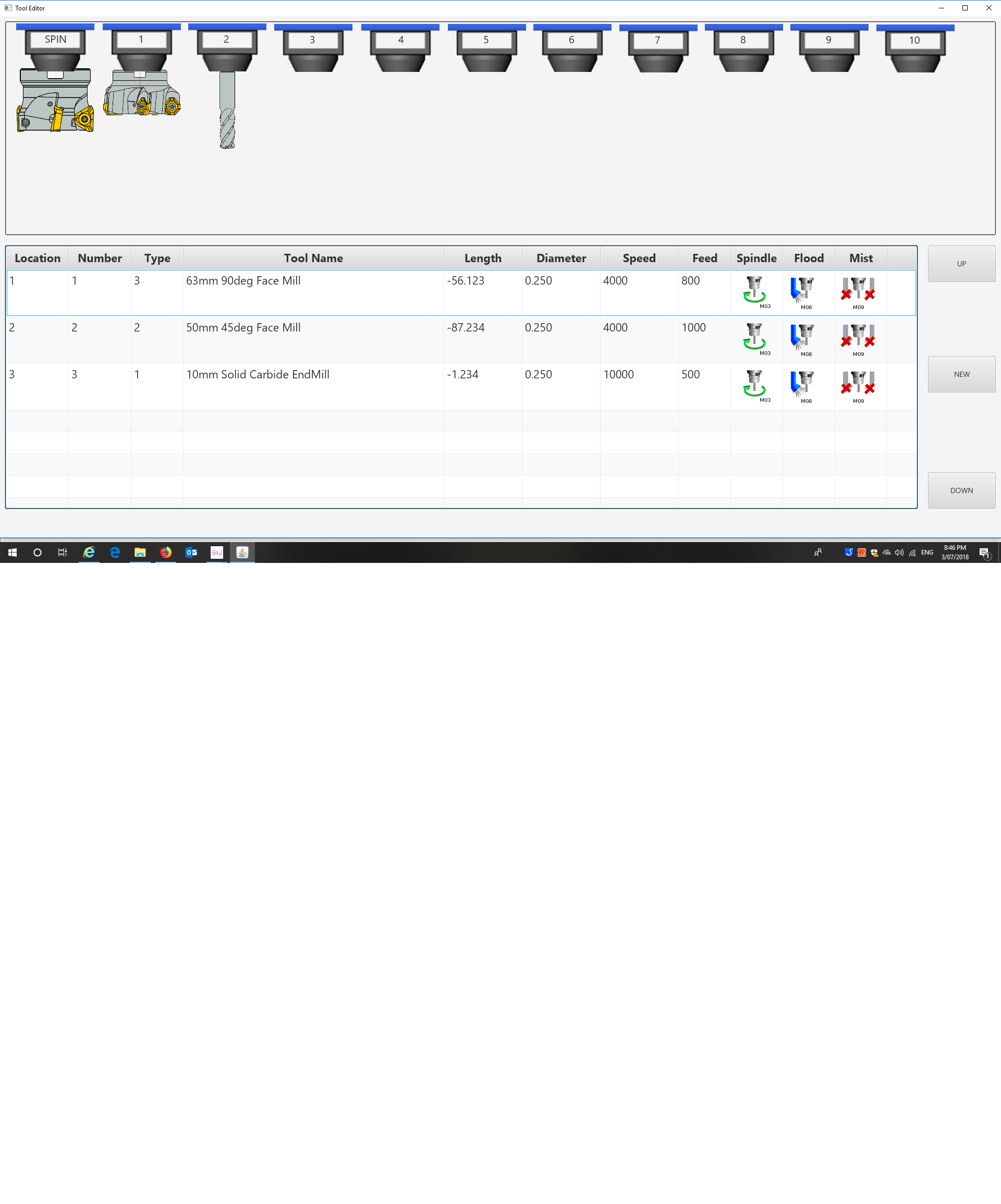

Thanks, the 2 tooltable method seems to be working for me. Attached is a screenshot of my first rough attempt which seems to be working.

beautiful!
Wanna build some widgets for qtvcp
i am not sure if you are referencing gladevcp widgets for your work (or if you are using python) but I will warn you if you use your tooltable to actually edit linuxcnc's tooltable file, you will want to add code to make sure the OS doesn't cache the data.
