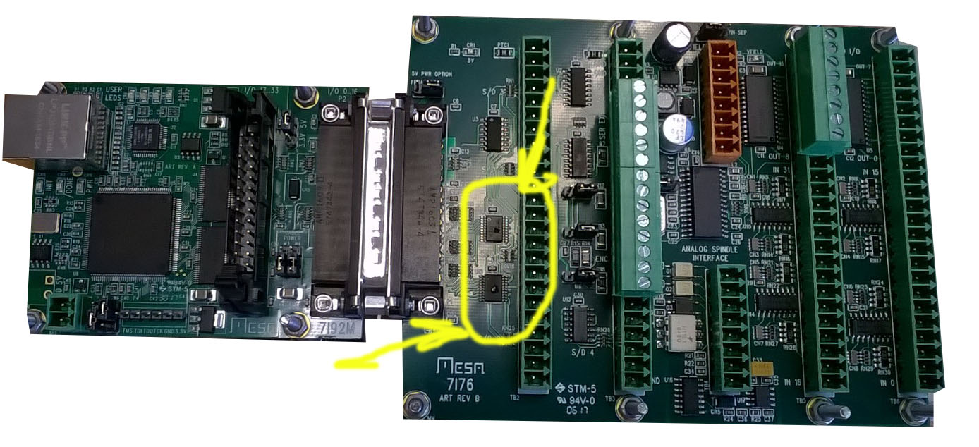

24 Jul 2018 18:04 #114755
by aleksamc
Replied by aleksamc on topic have problem with running linuxcnc and mesacard
- Posts: 18105
- Thank you received: 5328
24 Jul 2018 19:40 #114762
Replied by PCW on topic have problem with running linuxcnc and mesacard
Those are (or were) 74ACT540 and 74ACT541 buffers
They can be destroyed by excessive output voltage ( connecting the step/dir pins to 24V for example) or too high 5V supply (say >6V)

10 Sep 2018 04:51 #117279
by aleksamc
We have replaced that board with new, and also 7i92 board was broken also.
It possibly was high voltage from the servodrive. We has problem with it. It has inner short circuit from water condesate.
