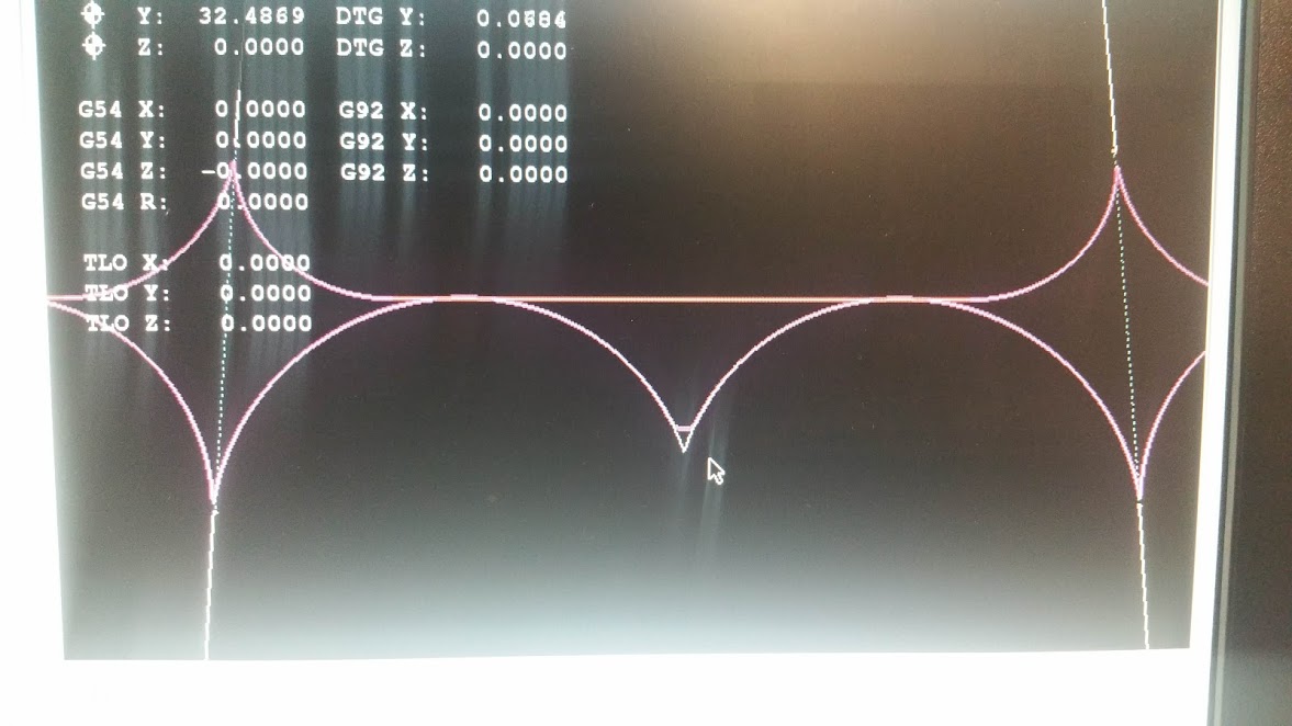

Rounding corners was created by rjd1234

You have acceleration set to low or you need to add G64 P0.x Q0.x at the top of the gcode file, where x is the amount of tolerance that the path should be followed, i.e. G64 P0.1 Q0.1 would get you within 0.1mm of the exact path.

Thank you TommyLight. This did the trick. After researching your post, I ended up using G61, which made it go to the exact point programmed.

Just remember with G61 set the machine will be coming to a stop in all corners (no mater how small). You might be very surprised how much faster the machine might mill with G64P0.01 (or some other small number) and still give you acceptably precise corners. This can be especially true with cam generated g-code.

To me the weird thing was that some of the corners were rounded, but others weren't. In fact, some of the corners that were not rounded were more acute angles than the ones that were. I'm not sure why the algorithm would do it that way. For the cut that I'm currently working on, a full stop doesn't slow things down too much. The cut is taking around 12 min and comes to a full stop 36 times... I'm guessing adding less than 10 seconds.
I will run a test with G64 P0.1 Q0. vs G61 and time it. That would be interesting.

I ran a test using G61 and it took 14:03. Then I switched to G64 P0.004 Q0.004 and it took 14:11. (0.004 inches is close to 0.1 mm).
