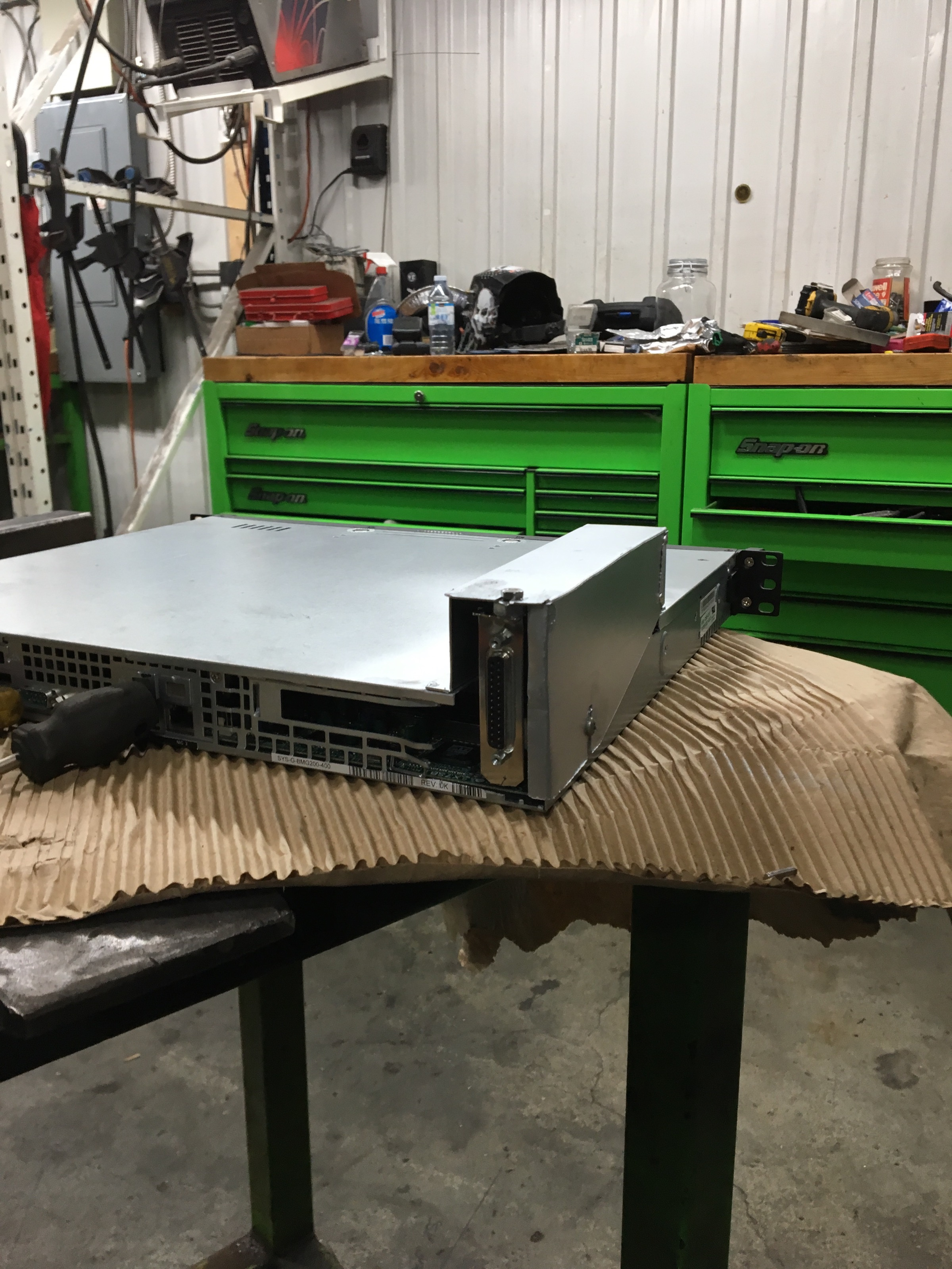

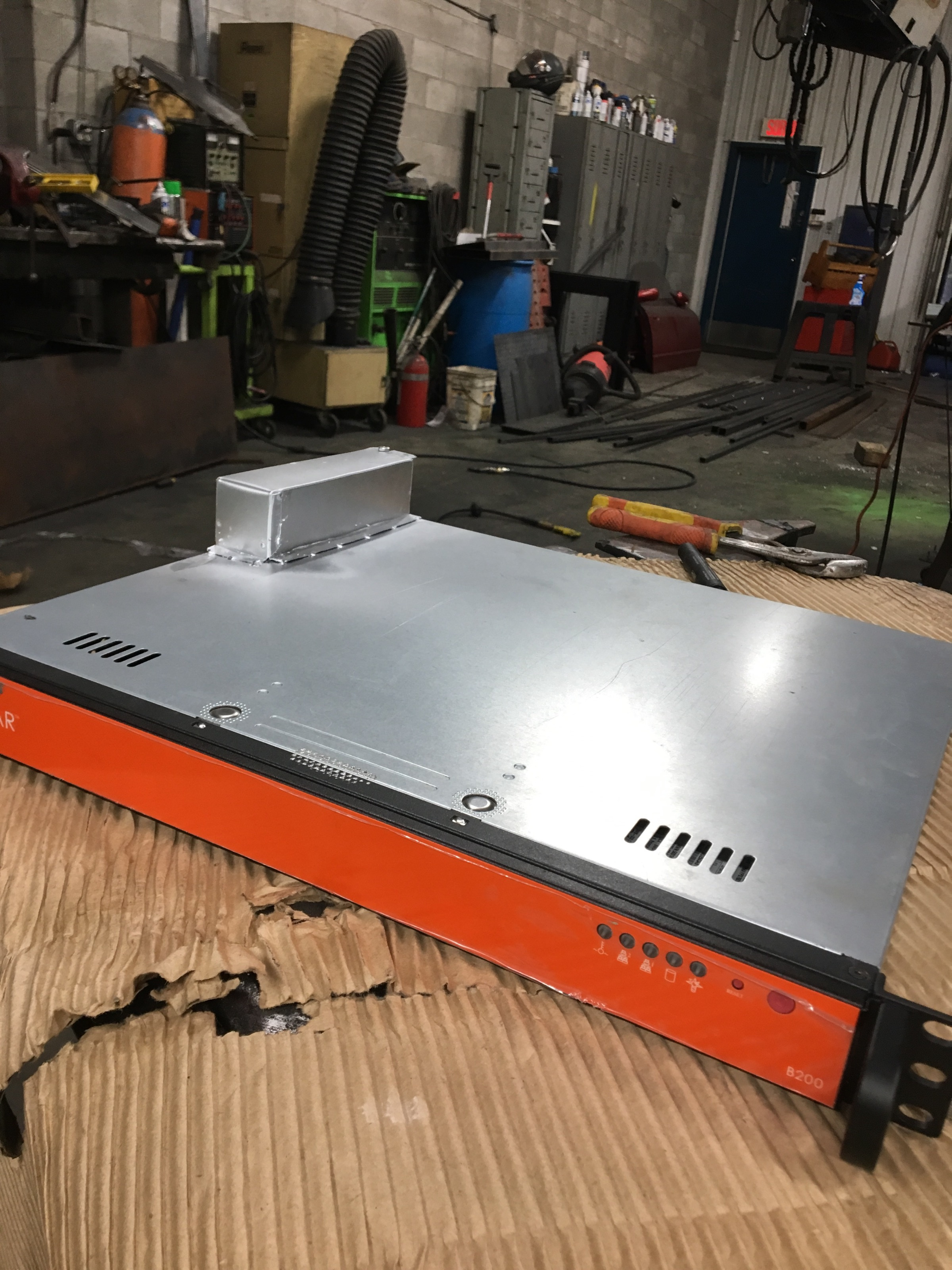

Your 5i25 was a pretty wild hack
could you have used a right angle header to lay it down?

It has a slot for a sideways pci riser but I didnt feel like researching it.
