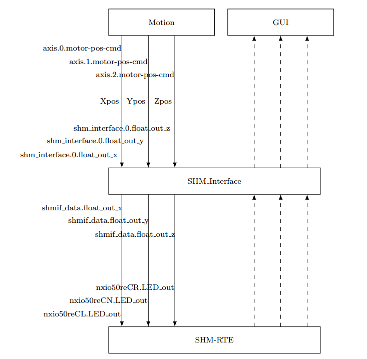

how to get the motion cmd?

by bevins
Replied by bevins on topic how to get the motion cmd?
Checkout the Linuxcnc NML interface.
linuxcnc.org/docs/html/config/python-int...nuxcnc_python_module
A couple places to get you started.

Thank you for your answer.python_module,i know that.but I want to know if I can use c?

Yes you can. C "cover functions" can be written to give C applications access to NML.The NIST site has code examples.
I don't know if Linuxcnc site goes into detail, but head over to nist.gov site to get started.

Replied by andypugh on topic how to get the motion cmd?
I am not sure that I fully understand the question, but if "SHM" in this diagram means "shared memory" then the shared-memory layer in LinuxCNC is HAL, and most drivers are HAL modules (written in C)
The LinuxCNC implementation of EtherCAT already exists as a HAL module, so I don't think you need to re-invent anything.
The EtherCAT implementation os not distributed as part of LinuxCNC, partly because of licensing issues with Beckhoff.
Details of the EtherCAT driver here: forum.linuxcnc.org/24-hal-components/223...-driver?limitstart=0
