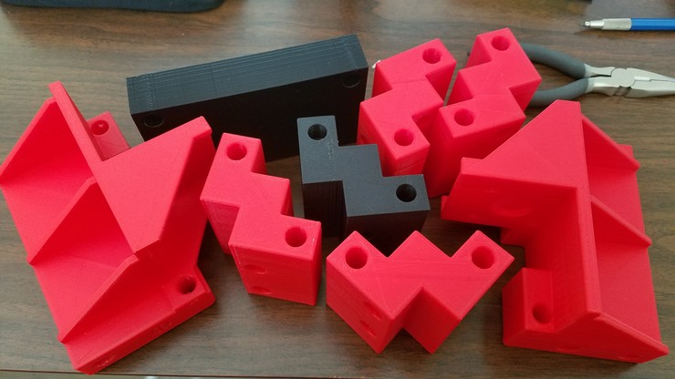

- aliaj00
- Posts: 16
23 Aug 2018 19:25 #116500
by aliaj00
Replied by aliaj00 on topic Need opinion on how, and if I can make a EDM machine with linux CNC :)
printed so parts yesterday.

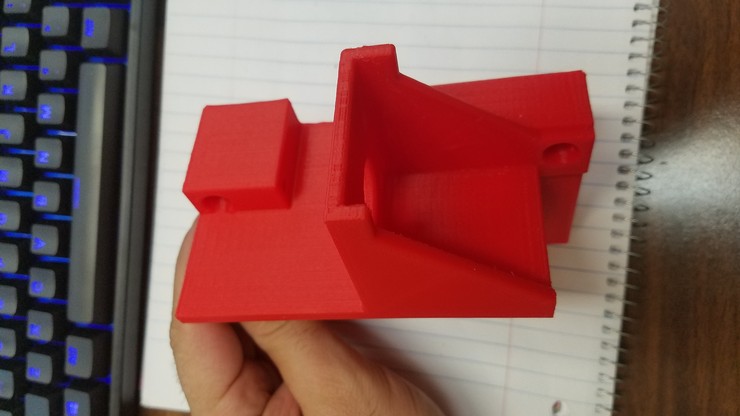

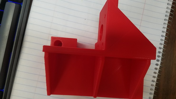

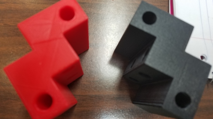

- aliaj00
- Posts: 16
24 Aug 2018 13:25 - 24 Aug 2018 13:27 #116543
by aliaj00
thanks
its taking a long time to print them nonstop on prusa i3 clone. Here is what i have got so far. Also the book finally arrived and it looks very nice. i think i can update the design a little bit to fit my small machine.in the book he is using a 555 chip i will go with an arduino and see if i can improve the logic a bit according to my needs. one of the y axis is not printer as good as the other as i was trying to find the right setup but it is usable "i might replace it anyway". now need to print the rest. A slow process.
Tim
Tim
