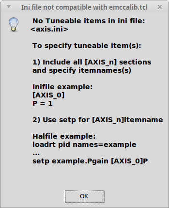

Hi, Sorry for my english. Look at my problem:
When I open EMC with my confogs and click "Calibrate axis" in linuxcnc - nothing happens.
If I create config from examples (AXIS) - "Calibrate axis" starting and working.
Whats wrong?

What branch of LinuxCNC are you using? Nothing Happens == the popup window does not appear? What GUI are you using?
In Axis if there are no tunable parameters the screen still shows up.

2.7.0What branch of LinuxCNC are you using?
yesNothing Happens == the popup window does not appear?
AxisWhat GUI are you using?
Sorry but I dont understand what u mean.In Axis if there are no tunable parameters the screen still shows up.

No.I can see this popup.

What is not working?

Sorry. I cann't see this popup.

Run LinuxCNC from a terminal and see if any errors show up in the terminal.
