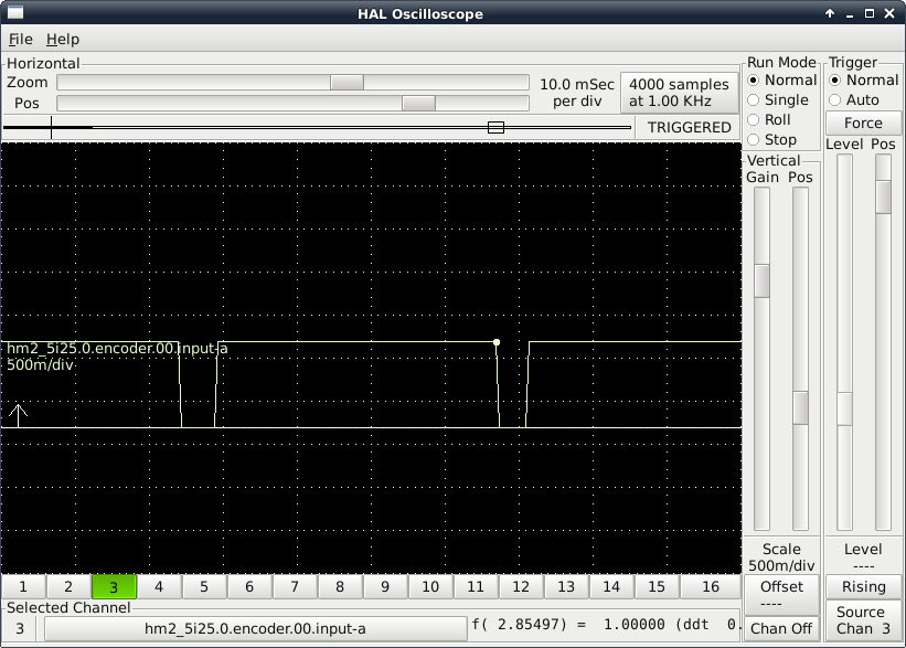

Help Please! I have spent hours trying to get the RPM display to settle down. I had this working with a reflective sensor and my old spindle motor. I changed my spindle motor to a DYN4 1.8kw servo and changed the index sensor to a slot type sensor. If I connect the sensor to my old DRO tach input it works perfectly. RPM varies by 2 or 3 RPM. I also checked the RPM with a Biddle mechanical tach and it matches the DRO readout.
Below are my hal file entries that relate to the spindle and a screen shot of the pulses from the sensor connected to the 7i76 encoder phase A. After I get this working I am going to work on getting the PID to bring RPM closer to the commanded RPM. Then connect the encoder output from the DYN drive to be able to do rigid taping.

Try setting the lowpass gain to between .005 an 0.1
Also since you have such a slow encoder signal you probably want to maximise the electrical noise filtering
by enabling the encoder filter and setting the sample rate lower:
setp hm2_5i25.0.encoder.00.filter true
setp hm2_5i25.0.encoder.sample-frequency 500000
This will set the encoder inputs digital filter time constant to 30 usec
(default time constant on a 5I25 with the filter off would be 100 ns = 300 times shorter)

I tried .01, .001, .002, .003, .004, .005, and previously 1.4,1.2,1,.9,.6,.5,.1, .01, .04,.05,.06. None of these setting make me think I am getting close.

lowpass gain numbers 1 or over make no sense
Is the RPM readout approximately right?
How are you looking at the spindle speed? the lowpass gain should make a dramatic difference in the displayed number jitter.
The smaller the lowpass gain number, the longer the filter time constant. Long time constants should smooth the displayed speed but too long will cause the filtered number to lag excessively.
Did you change the encoder filter settings I mentioned? It would be good to do this to rule out electrical noise

Apparently I follow instructions much better after some sleep. I changed hm2_5i25.0.encoder.sample-frequency to 500000 and it worked. I then backed the number down by halving it. 20000 is where I ended up and it is working great.
