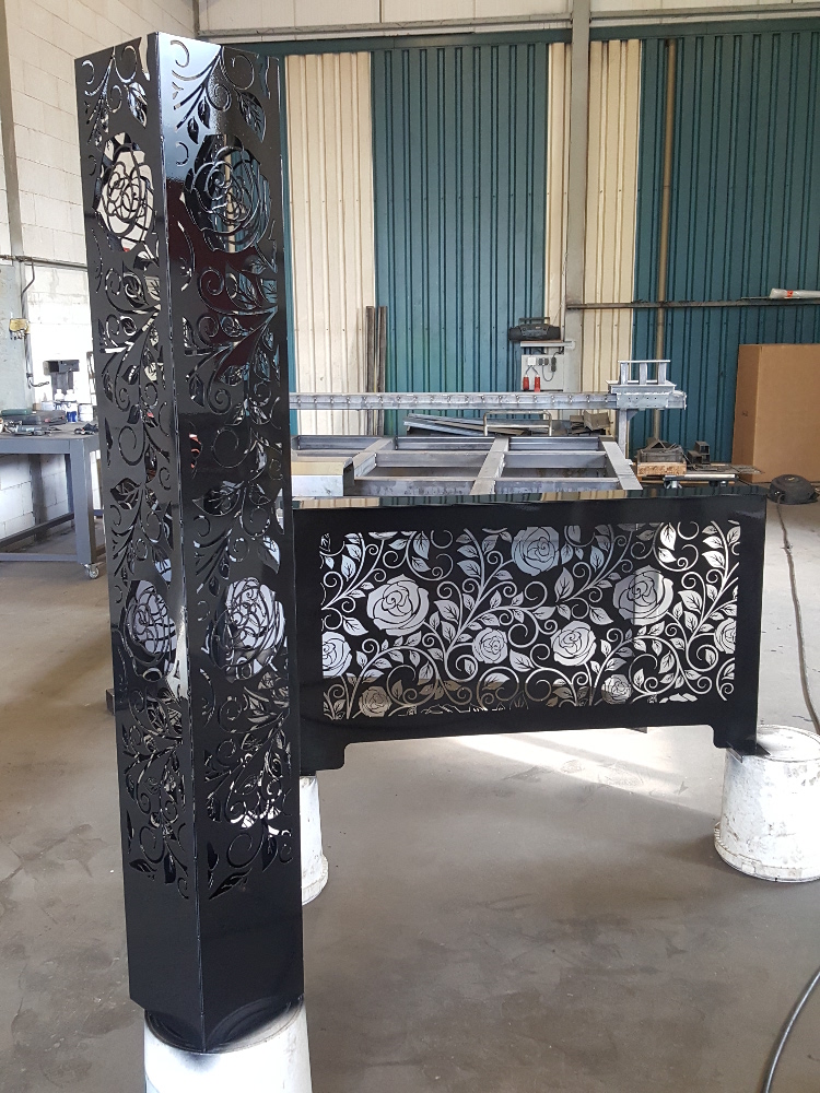

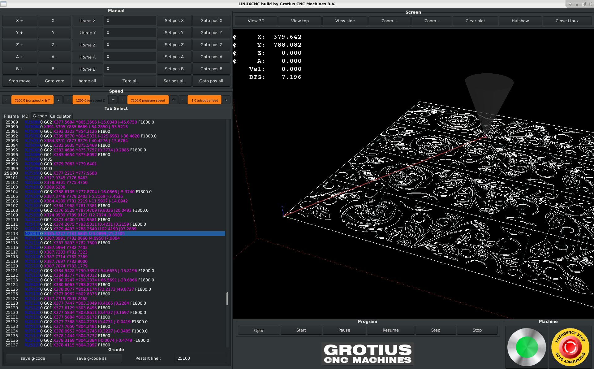

I started a program. The program is about 2.5 hours. At 2 hours the torch had a collision and e E-stop was triggered.
How to restart from line 25010?
Has someone also had problem's with restarting from a certain line?

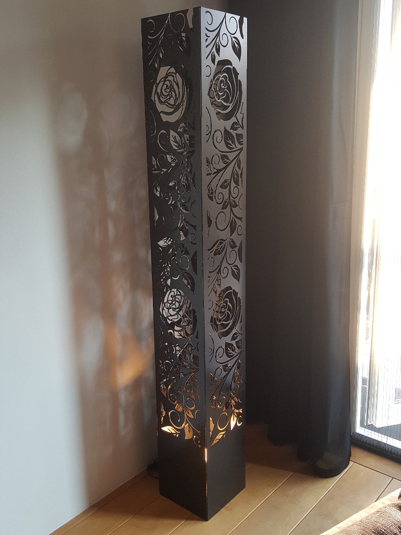

The left item is a standing lamp for in corner of room. This item has a large nc file.

Replied by tommylight on topic E-stop pressed, how to restart at line 25010
Right click on the line you want to start from, click on "run from here".
That works always. You can also make an empty file named "last_position.txt" inside the config folder you are using and add the line "position file=last_position.txt" somewhere in the ini file, have a look at toma config, it is already there.
If you get an error when using run from here, scroll back some lines till you get to a line that has no radius and start from there. You can not start from a line that has radius’s as you will get an error.

Here is the source code github.com/michelwijnja/external_offsets...b/master/bin/grotius
The problem is over here in the source code :
Okey i think i missed something in my code. This is the code for restarting at certain line.
my linuxcnx command is renamed to c.
command is the line number. Here i missed something?
I have 2 probem's to solve to have a perfect working system. This is one.

Hi Wonderful Bigjohn and Tommy,
I solved the problem.
It was a very simple issue that had to do with the screen replacement to fill different monitor resolution's.
I will be working at the screen resolution again next week. The height is a little to big i mentioned on older monitor's.
Some glade signals will not go with copy / paste to the new layout.
So i checked that. Normally you can use a glade command without python code to start. This is not what i need.
So i did a button start event where it alway's read's the line input at certain line if you press start. How nice can it be.
This code is working perfect for restarting at certain line :
Thank's guy's
def on_start_pressed(self, widget, data=None):

- Posts: 21986
- Thank you received: 7486
02 Sep 2018 20:16 #116993
That looks awesome.
Done some of those a while back for a big local restaurant, i proposed the idea and one of my customers did the cutting.
By big i mean that restaurant can seat 600 people, used mostly for weddings.
Grotius, nice job !
Grotius, nice job !
