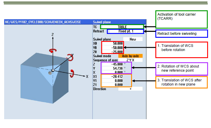

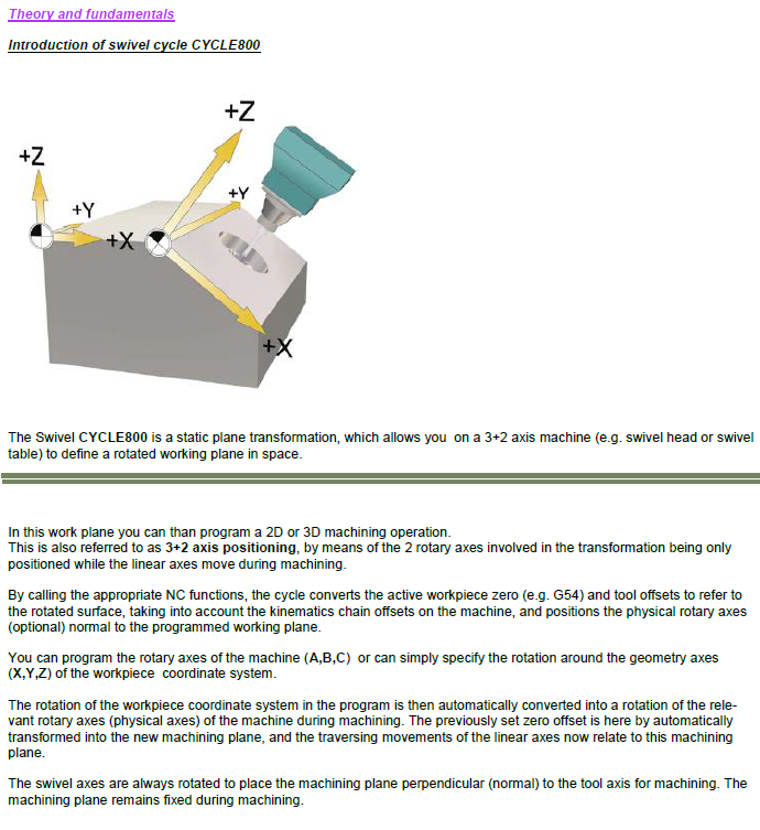

Hello,
I would like to try a different aproach on 4 and 5 axis kinematic transformation. In attachement you can see how they define working plane on Sinumerik. My idea is to make something similar to cycle800 on LinuxCNC. For this to work the first thing is to be able to apply rotation around every geometry axis, just as it is already possible to do around Z.
I don't have enough experience with the core of LCNC, so I am looking for someone to help me there.
I also have commissioning docs for Siemens, where one could get the general idea on how this should work.

I thin a lot of people would benefit from that, not only 5 axis machines and robots, but also simpler machines with manual tilting vertical/horizontal heads, even lathes with motorized tools,...
