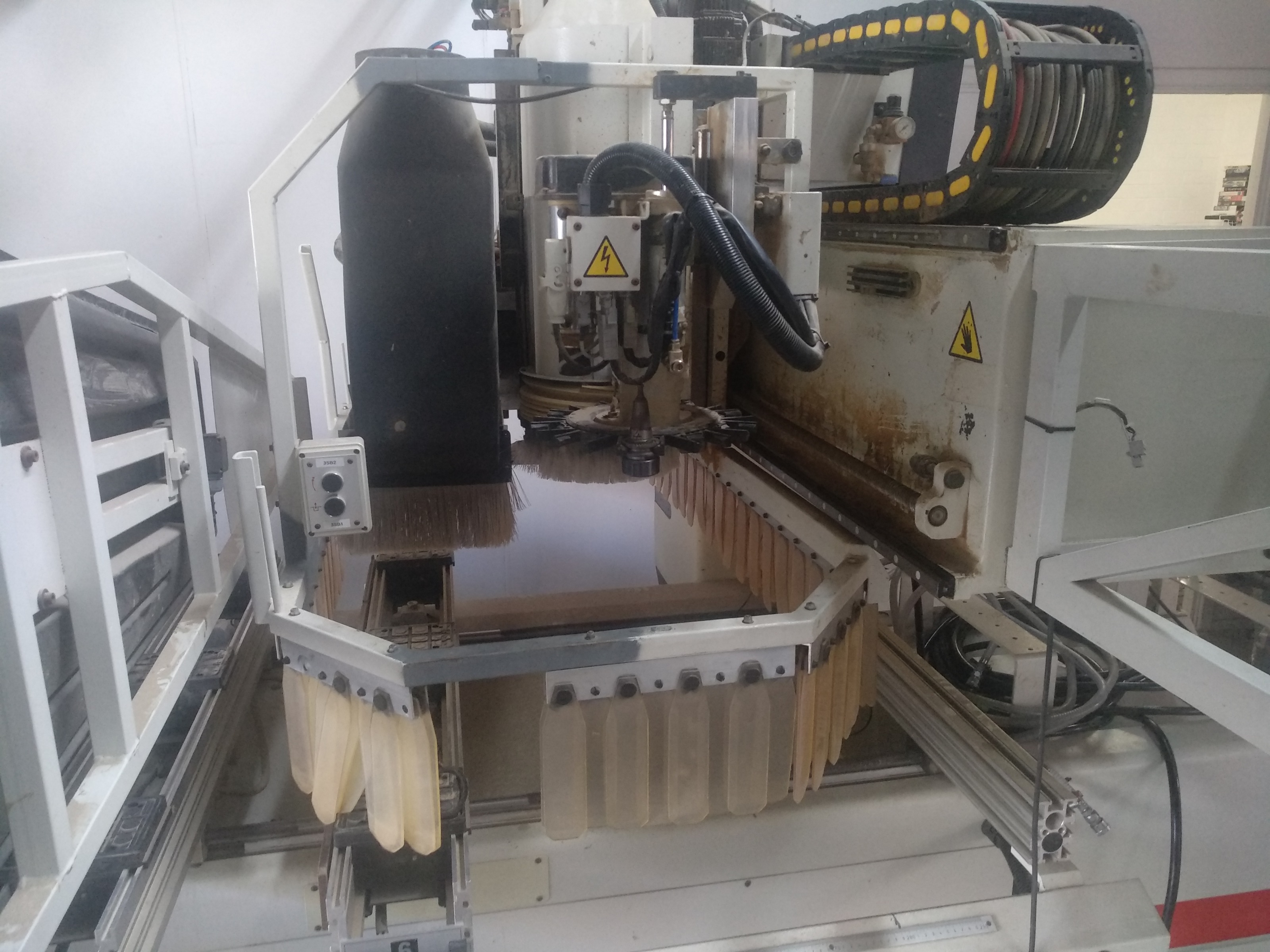

Why? Because I wanted to build a bigger CNC that could cut a foam windsurf board and other projects on the side. I work for myself out of this factory unit doing fiberglass repairs.
First idea was to build a 3axis Mach3 machine from scratch, but I found this website and now I'm stuck here.
I chose this Morbidelli because it has a lot of clearance under the gantry, 430mm. Enough room for a windsurf board.

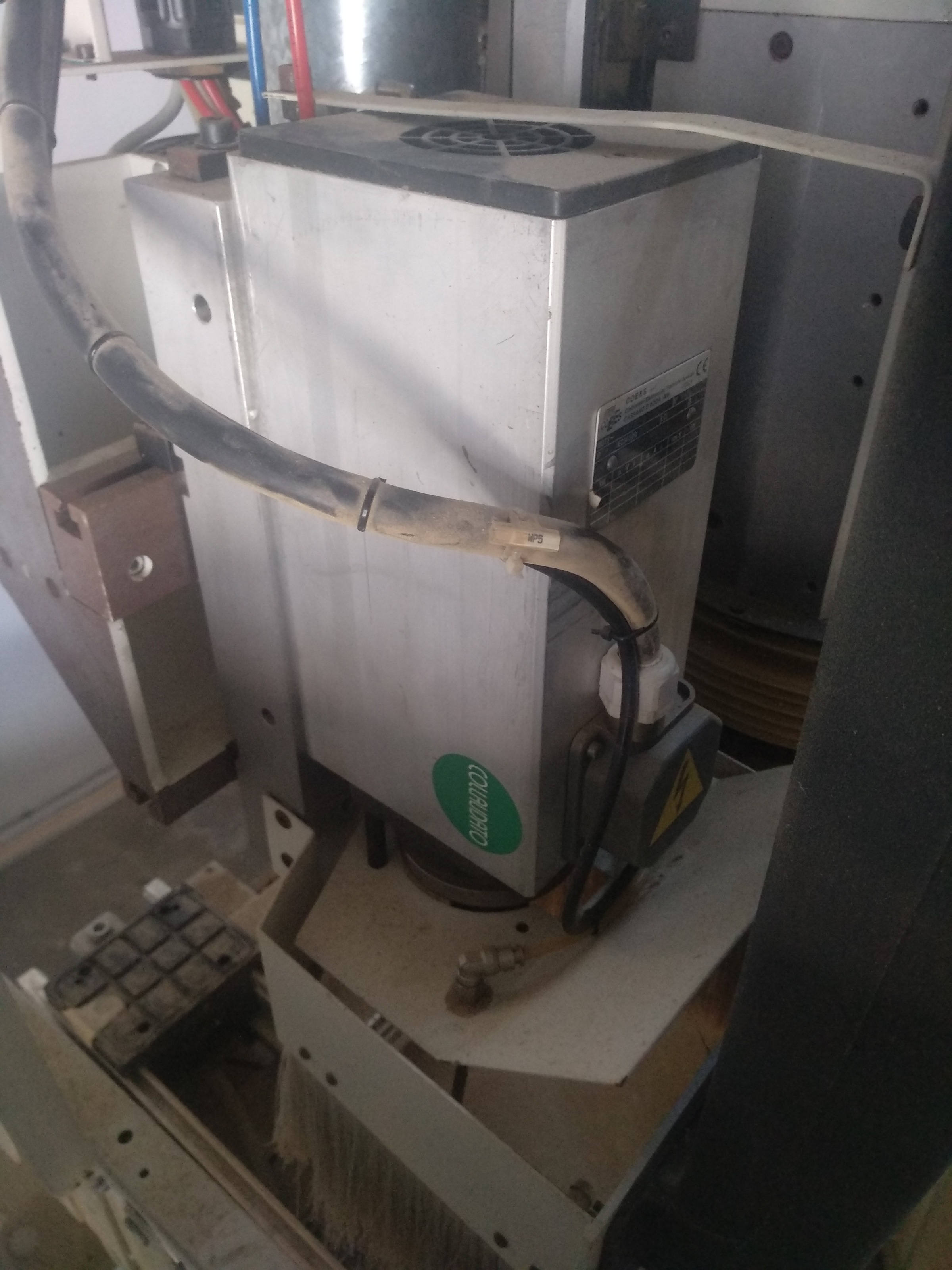

Unfortunately, I can only access this clearance if I remove the pod and rails. Another negative is the existing Z axis travel is also only about 200mm, so I'll replace the 'cabnet making' setup with a simple spindle with more travel.
Maybe I can remount the electro spindle and even the tool changer?

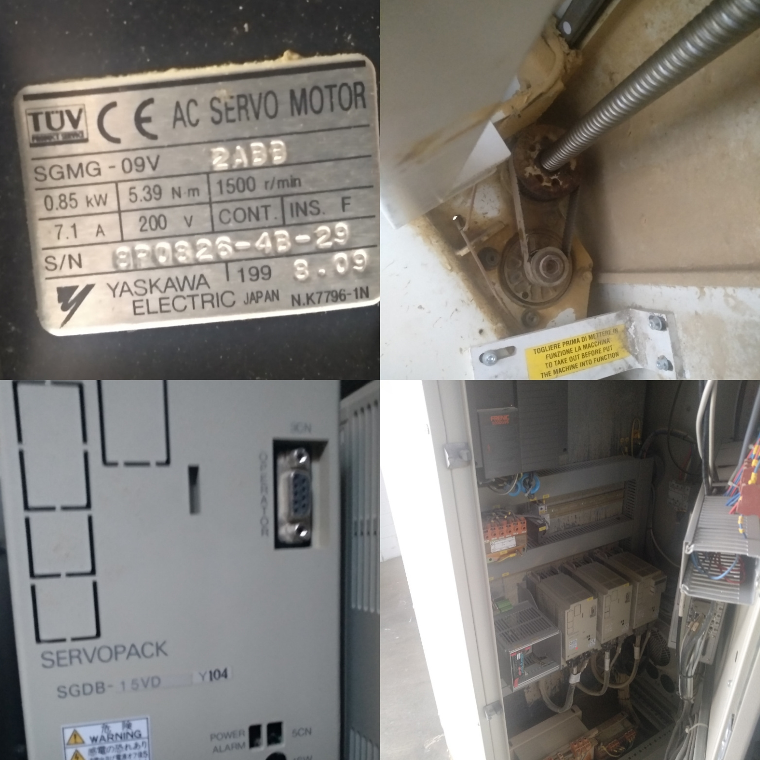

The servo motors are...
Yaskawa
SGM-09V2ABB
0.85KW
1500
7.1A
200v
Servo Drivers
Yaskawa Servo pack
SGDB-15VD Y104
Unfortunately I don't know much past basic Mach3, and I know next to nothing about Linux!
Any tips on the next step would be a great help!
Yaskawa
SGM-09V2ABB
0.85KW
1500
7.1A
200v
Servo Drivers
Yaskawa Servo pack
SGDB-15VD Y104

Find the PDF datasheets for the drives, check if they are controlled by +-10V analogue, check if they do work, buy a Mesa 5i25 or 6i25 or 7i92 together with 7i77 and start figuring out what is connected to whet and how. Basically that is it, but it takes a lot of reading and learning for a successful result.

The drivers and servos can be used with step and direction position control or +/- 10V analog velocity or torque control.
if you are used to Mach3 then you might prefer to use step/dir position control and you could even consider using the parallel port. However you would run out of IO pretty quickly if you wanted limit switches and tool-changer support.
Using analogue velocity control and closing the position loop in LinuxCNC might give better performance (as it allows feed-forward control). That will need some external control hardware (such as the 7i77 previously mentioned)
Pick a strategy and we will advise you on how to make it work...

meanwhile I've committed to converting this morbidelli back to a basic 3 axis router for simplicity and because I want more Z axis travel down the track. I've stripped well over 100kg of motors, drills, tool changers and I hope to remount the main spindle back on the current Zaxis plate(?) -
