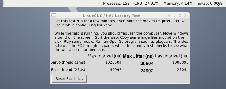

Maybe i already have the Preempt-RT kernel? Checked with these commands:
and
uname -vuname -amanfred@CNC:~$ uname -v
#1 SMP PREEMPT Debian 3.4.55-4linuxcnc
manfred@CNC:~$ uname -a
Linux CNC 3.4-9-rtai-686-pae #1 SMP PREEMPT Debian 3.4.55-4linuxcnc i686 GNU/LinuxPlease Log in or Create an account to join the conversation.

07 Oct 2018 21:17 #118519
by mane
After installing, i had very bad latency values > 100000.
After re-insallation Debian jessy 64bit and switching to preempt-rt kernel i had latency values between 50000 and 100000.
Maybe the debian 32bit has better latency performance than debian 64bit. And maybe the rtai kernel has also better latency performance than preempt-rt. With my first installation with rtai kernel, system latency was below 10000 with isolcpus option.
I will try out in the next days.,

07 Oct 2018 23:38 #118522
Replied by andypugh on topic UBM1 mill with LinuxCNC
It might be that your system will only give adequate performance with RTAI. In that case you would need to use a PCI Mesa card (Or EPP Parallel Pico or Mesa card) as Ethernet and RTAI don't work together.

11 Oct 2018 20:21 #118687
by mane
Replied by mane on topic UBM1 mill with LinuxCNC
After playing around with isolcpus command i have acceptable values with preempt-rt kernel.
In my case i have 4 cpu cores and put this into /etc/default/grub:
GRUB_CMDLINE_LINUX_DEFAULT="quiet splash isolcpus=0,1,2"
Now, only one core is present at the system which makes it a bit slower but still acceptable.

11 Oct 2018 23:05 #118689
Replied by PCW on topic UBM1 mill with LinuxCNC
Note that getting this good latency is important with parallel ports but if you use external Ethernet hardware you are likely better off leaving ISOLCPUs alone
(You will typically get better Ethernet latency with all cores running)

16 Oct 2018 14:13 #118879
by mane
I tried several installations during the weekend. Good latency seems to be impossible with my board and Preempt-RT kernel.
Switched back to the regular linuxcnc with Debian 7 and rtai kernel.Thats even better.
Think i will go with a 7i43 and parallel port.
Thanks so far for all your Input.

16 Oct 2018 14:28 #118880
I am confused by this statement, as you seem to have already demonstrated good latency with the preempt-rt kernel.
Good latency seems to be impossible with my board and Preempt-RT kernel..

16 Oct 2018 15:19 #118885
by mane
I had only good results with preempt-rt kernel by using
But as PCW said i should not use isolcpus together with ethernet.
Thats why i go back to parallel port.

16 Oct 2018 15:25 - 16 Oct 2018 15:29 #118886
"good latency" depends on whether you have external step generation hardware
100K latency is probably fine for an Ethernet stepgen card ( but not for a parallel port interface)
