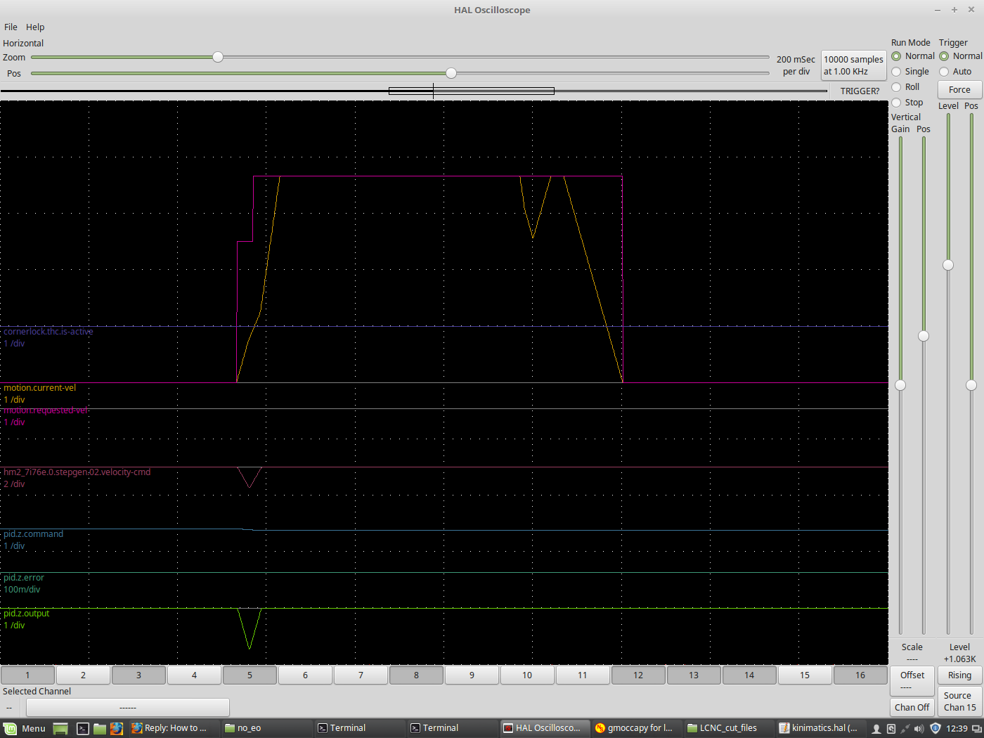

Sorry I didn't run a before test. I have also done a "dry run" test to see how this patch works. The code segment displayed on the Halscope trace is:

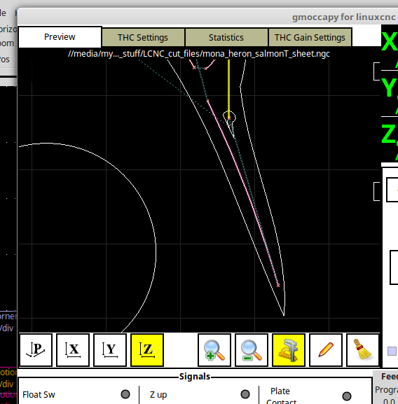

Screen shot of path preview:
Ok, here is a Halscope output for some signals while this code is executing.
The motion.requested-vel trace is just as we want it, the output of the TP showing a constant velocity. The problem is that the motion.current-vel trace shows a slowdown at the exact point that gets a "divot" when live cutting. So for the time being I am not sure about what is going on. The other traces shown have to do with the Z axis motion, position, commands and errors to see if this is caused by Z motion, which it is apparently not.
I have run out of time for testing today so this is all until next week after market.
John
John
John, I kinda think this is expected behaviour. The trajectory planner for some reason has decided it cannot honour the requested velocity and has reduced it to what can be done by the laws of physics for that line segment. But at least it has not stopped motion!
Is it the inside cut where the green line is that you are cutting? Maybe you can modify the drawing to use a rounded corner.
Bugs aside and apart from from altering the g-code, I think the only solution is to improve the acceleration profile of the machine. That might imply some expense (for high performance servos etc)....
I would trial that in a Sim by increasing the X,Y acceleration significantly from your current settings to see if the dip flattens out.
07 Nov 2018 23:19 #120221 by islander261
Replied by islander261 on topic How to update from GIT
Rod
Sorry for not being specific about the cut. The cut in question is the long split in the beak that runs diagonally down the part. It is composed of two arc segments. The slowdown is centered on the junction of the two arcs. Using the eyeball method it should only take minor changes in velocity for the trajectory to stay on the path. The other strange thing is the difference in the time to accelerate everything to speed at the start of the cut and the time it takes to slow down to a stop at the end. This is a stepper system so the controller has no knowledge of the real position during the cut. The system doesn't loose any steps at the velocities and accelerations I have set.
I have done significantly more testing of this location and a couple of others. This is a blending issue because I can alter the the actual cut path and force the TP to make the whole cut one straight line by using extreme values of P and Q with the G64 instruction. I have also tried setting the arc blending to the "old" method in the TRAJ section of the .ini file with no apparent change in the results. I have run out of ideas for testing at this time. If anyone has any suggestions for things to look at I will. For now I am putting this into the "just the way it works" box and living with the results. The new TP blending fixes have cleaned up many other problem spots.
John
