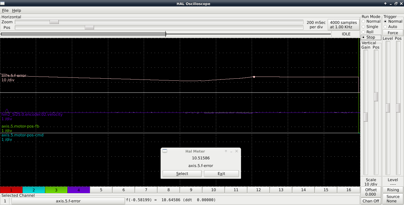

The C is what is driving me crazy. The drive is set up to output 9000 PPR (36,000 counts per rev). The motor drives the spindle by timing belt at 2:1. I currently have 2 configs set up. One has the encoder scale and output scale in degrees, the other in revolutions. For my calulations I am accounting for the belt reduction and using the numbers at the spindle.
I have tried many PID values, but currently these the closest I have come. The ferror is always around 10 degrees when stopped, never going close to 0. The servo is not very stiff, and is both twitching in small amounts, and wandering 10-15 degrees. When jogging the axis it only moves slowly while jumping forward small amounts occasionally. Comments are posted here only, not in config
ENCODER_SCALE = 72000 #counts per revolution
OUTPUT_SCALE = 25 #revs per second at 10V (1500 rpm)
P = -0.0015
I = 0.0
D = 0.0
FF0 = 0.0
FF1 = 0.00111111 #lowered to stop jog runaway (overshoots waaay too far) shouldn't it be 1?
FF2 = 0.0
BIAS = -0.0025
DEADBAND = 0.00004

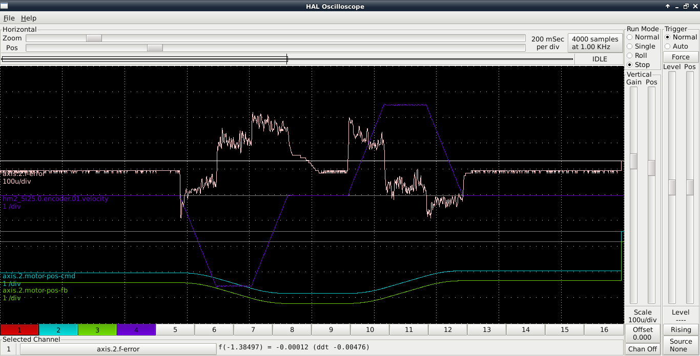

Here is a halscope capture. It's probably not of any use. I'm attempting to jog the C axis, but not much is happening.
I'm confused about what I should set FF1 to be.

it sounds like the spindle drive is not set up for velocity mode
Does the spindle work properly open loop? (expected RPM over the full spindle speed range)?
If not, its not running in velocity mode.
( open loop spindle means P/I/D = 0 FF0=1 FF1=0 FF2=0)
Note that you will typically have different tuning in spindle and C axis mode since the first uses a velocity
command and velocity feedback and the second uses a position command and position feedback.
