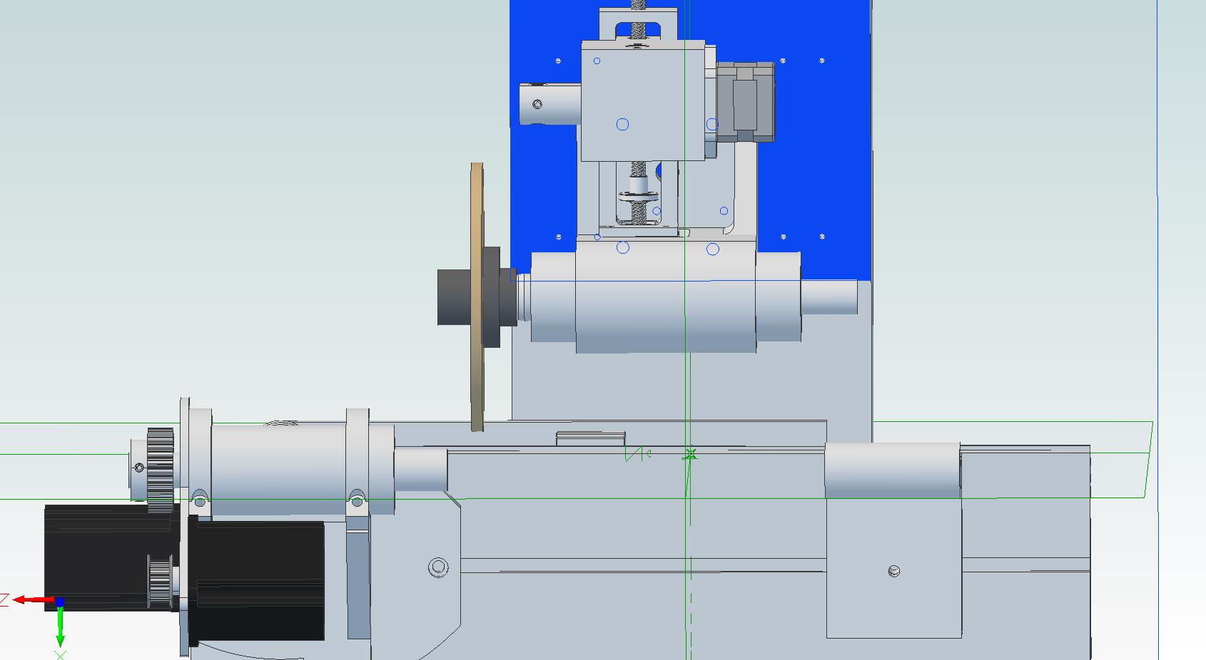

That should be possible. Maybe using kinematics, maybe using kinematics. Possibly just by adding X and U before passing them to the stepgen.
Does the exact wheel diameter matter to the system? If you go back to my mockup using a CD to model a grinding wheel in that case the wheel diameter is a critical part of the calculations as it determines how the contact point rolls round the eccentric.

The wheel diameter is very important to the cam profile but a few thousandths on a 7 inch diameter wheel wont be a problem.
When the OD grinding mode is active the wheel diameter in not critical.

Should have said "That should be possible. Maybe using kinematics, maybe using external offsets"
Though a better way occurred to me later, which is using tool offsets. I can't decide between using X offset (like a lathe) or radius offset.
I suspect that using tool-radius compensation might be a good solution if the rotation angle can be programmed as Y in the G-code.
In either case, I think that tool table and wear offsetting is likely to be the answer here, with the wheel-dressing routine calculating a new tool offset and programming it with G10 commands.
Replied by andypugh on topic Need some ideas on how to set up a home built OD/can grinder
