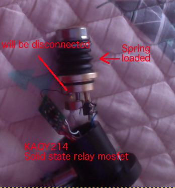

Hi
Between your points 19x7-2 and 19x7-9
24VDC regardless whether the tool setter is depressed or happy.
BAD. You will never get a change on io. First there must be a change!!
Measure if 3a1-5 is on gnd level.

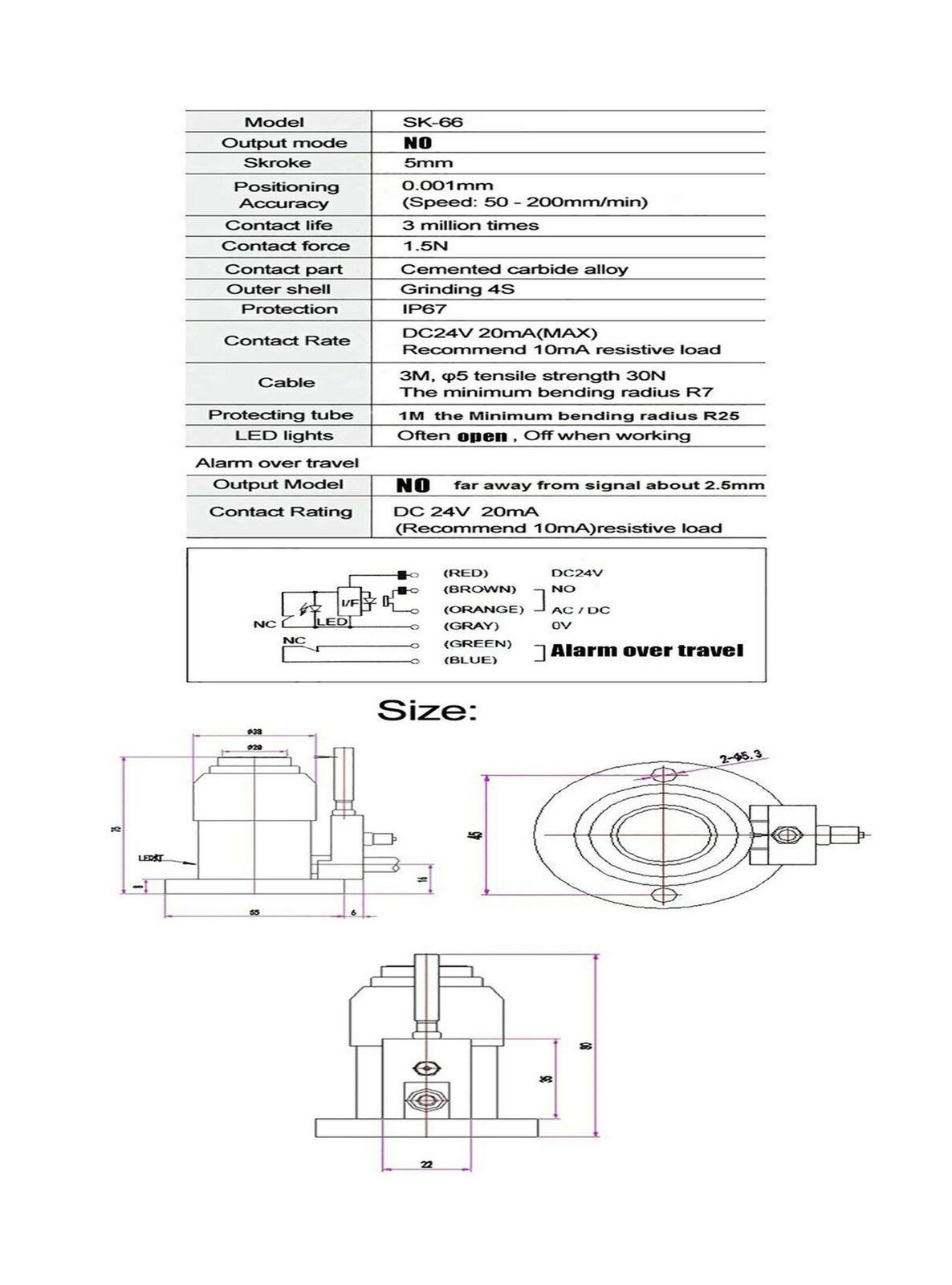

Hello Andy,
no mine is a bit different. You can see it and its schematic here.
It seems to be two separate circuits for the two switches.
Mark
Mark

If it is just two physical switches then I think you would just wire the switches between 24V and a 7i76(?) input pin.

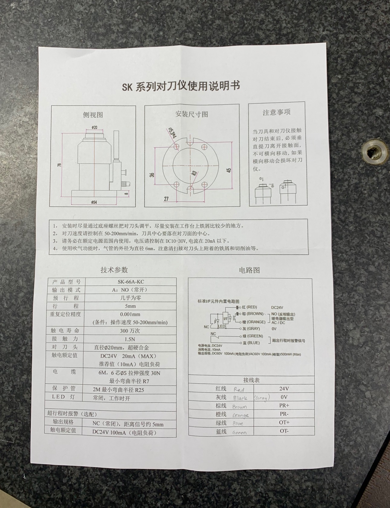

The instructions include a limitation on not more than 20mA current. Wouldn't shorting 24VDC directly though this switch to a 7i77 input pin exceed that current limit?

Digital inputs are high impedance. They have to be ur nothing could ever change their voltage level.
If you want to be sure, use a multimeter in current mode to connect an input to +24V. You should see a state-change in the input and a few mA of current.
