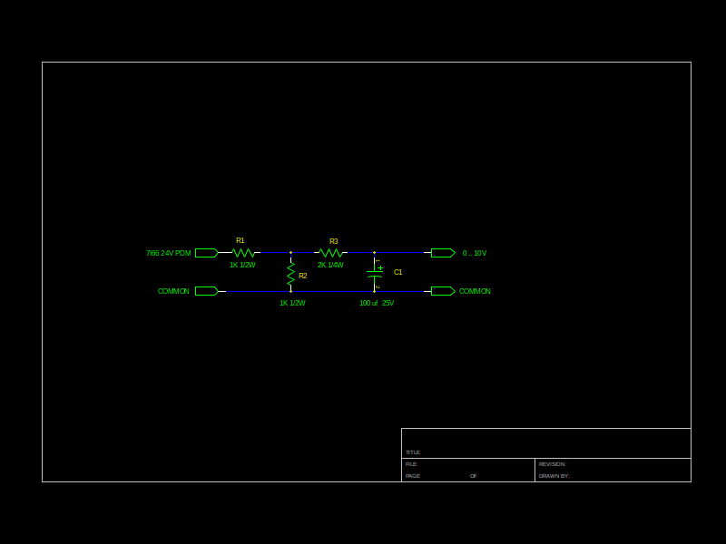

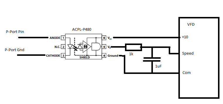

If i generate a PWM on the 5i23, is it still possible to create a 0-10V signal?
I tought the 5i23 only can get 5V on it's pins.

05 Dec 2018 15:17 #121887
Replied by PCW on topic PWM gen
- Thank you received: 4654
05 Dec 2018 15:18 #121888
It can be done if the VFD has +10 and 0V terminals for a potentiometer:
Replied by andypugh on topic PWM gen
05 Dec 2018 15:19 #121889
Or you can configure the VFD so that 5V is the max required speed.

@andypugh and @PCW thank you very much for your help. I will probabbly go for the solution of PCW because it was the one that comes the closest to what I was thinking.
