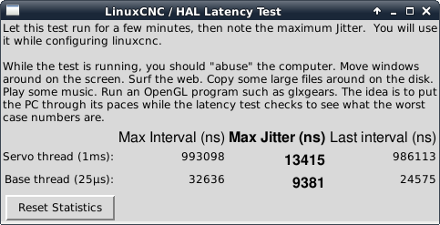

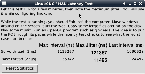

I am new to CNC and this forum. I am trying to set up my first machine and I have linucnc running on a gigabyte E3000N. When I do the Hal latency test I get over 125000 on the servo thread and less than 15000 on the base thread. I tried to turn off all things in bios and in the OS(the screen saver is bad). I also tried maxcpus and isolcpus etc. But then I saw that if I have glxgears running I get good results for Servo around 13000 and 10000 for base. Se pics. I made a video with latency-plot turning on and off glxgears.
I have a feeling this is due to some energy saving setting? When glxgear starts something wakes up.
or since I run in dual core maybe glxgears blocks one core? but I tried to run one core and It did not help. Hmm
Anyone had this problem? Any ideas?
For now I will just run with glxgears in the background.
With glxgears running. OK
No glxgears running. BAD

Replied by PCW on topic Servo Max Jitter bad without glxgears running.
That does sound like that is power management or perhaps caching related
Have you turned off _alll_ power management options in the BIOS?
(Cooll&Quiet etc etc)

Replied by tommylight on topic Servo Max Jitter bad without glxgears running.
Strange, it does that only for servo thread, base is unaffected !!!
Usually it is the opposite.
Never seen this happen.
