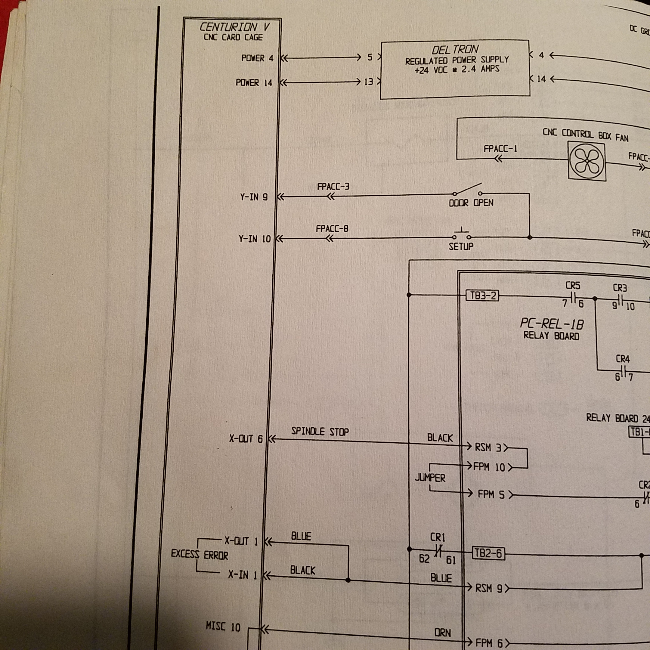

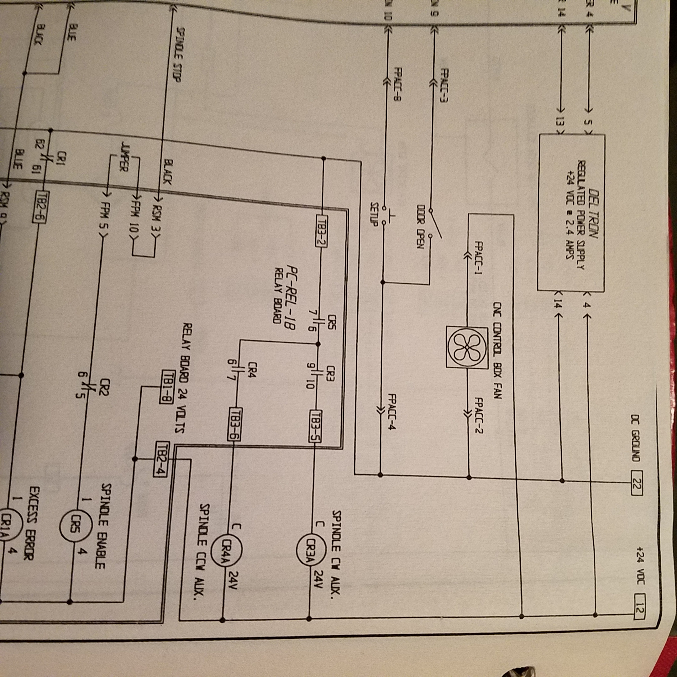

I am retrofiting 1997 Milltronics VM17 to Linuxcnc using Mesa. I am trying to match the Mesa board correctly. Can you tell by these schematic pictures?

It looks like active low inputs.
