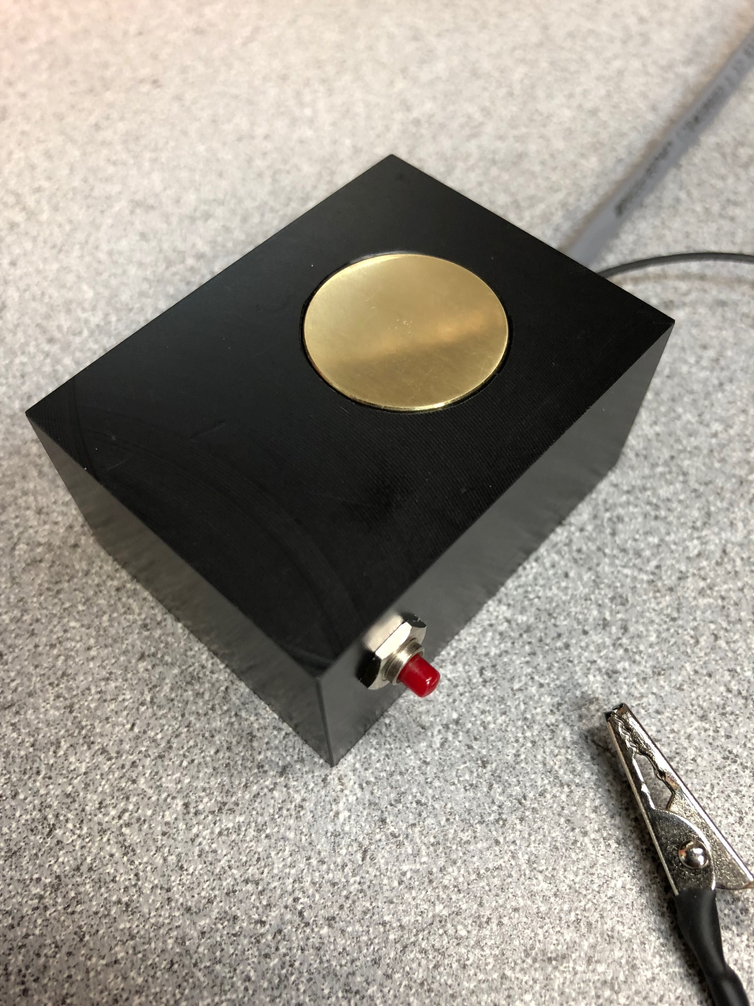

02 Jan 2019 13:40 #123328
Something spring-loaded is likely to be safest.
There are specific devices available for the job. Though making your own would be cheaper.
www.ebay.co.uk/itm/Werkzeuglangensensor-...4:g:S7gAAOxy3yNTfQx3
Replied by andypugh on topic toolchange protocol and manual toolchange touchoff
I'll have a look at auto-touchoff, but am concerned about the idea of using something (e.g. pcb) that results in a hard impact.
