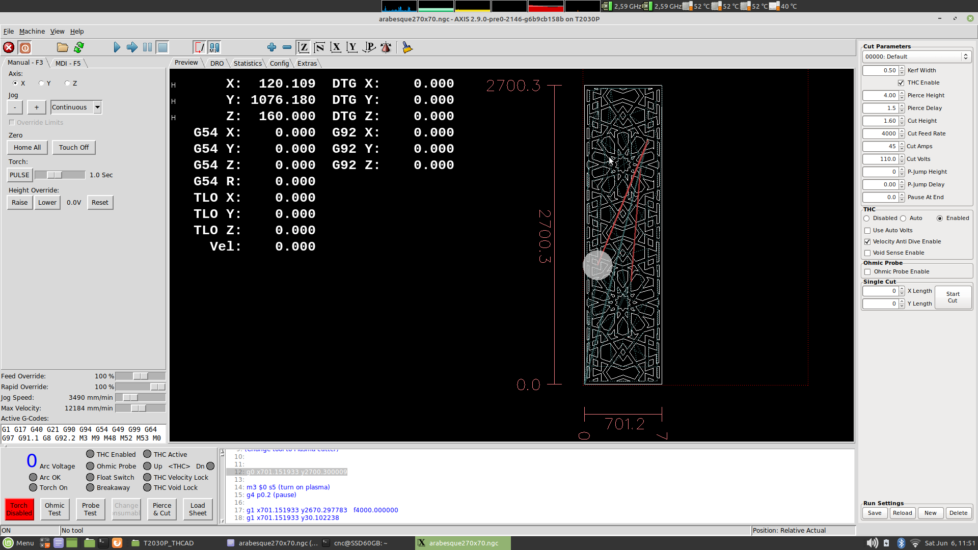

06 Jun 2020 10:31 #170337
Replied by tommylight on topic Strange behaviour after program stop button pressed in axis
Noticed the same issue on 2.9 build 2133 and 2146, using 3 different configs on the same machine, the PlasmaC, toma_thc, and a plain standard config.
The issue:
-start LinuxCNC, home the machine, load gcode file, press start,
-while in rapid, press stop or ESC
--what should happen is the machine should stop,
--what happens is the machine will start moving back, both X and Y axis, to some random point that is not random as it can always be found in the gcode, but that point will change, already had two positions that the machine goes to with the same config and same gcode file.
In the attached screenshot, there are two dark red/brown lines, the upper part of those lines is where the stop was pressed, while the bottom of those lines is where the machine actually stopped. Same config, same gcode, just reloaded the gcode, homed the machine and run. Both of those end positions can be found in gcode.
The same procedure using Gmoccapy with the same gcode and plain config is not present, so this affects only axis GUI so far.
The issue:

Replied by PCW on topic Strange behaviour after program stop button pressed in axis
github.com/LinuxCNC/linuxcnc/issues/865
RMU has a fix that seems to work but may have undesired side effects
If you are building from source you might try adding emCTaskPlanReset()
int was_open = taskplanopen;
emcTaskPlanClose();
++ emcTaskPlanReset();
at about line 261 in src/emc/task/emctask.cc
Thank you, PCW,
I am aware of that as i did read everything here, but the explanation on the original post was lacking, so i did some test today and it is repeatable and the return point is always somewhere in the gcode. The original poster named it as a dangerous issue, and rightfully so.
I use this for plasma cutters, so it has no real side effects as at rapid the torch is always up.
Just did an upgrade to build 2180 of master version and it seems this issue is solved.
Will do some more testing and mark this topic as solved, after confirming it.
Thank you, all.
