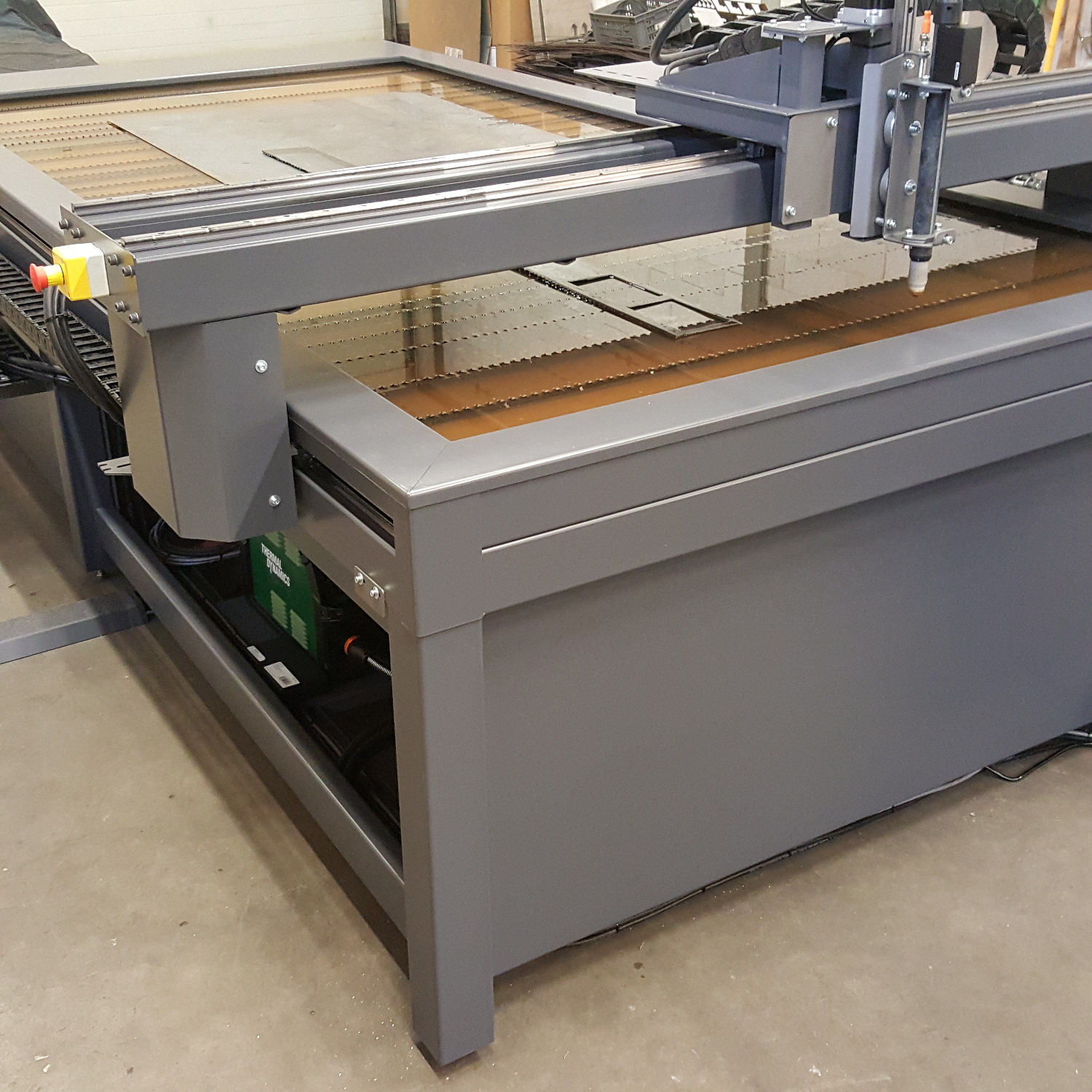

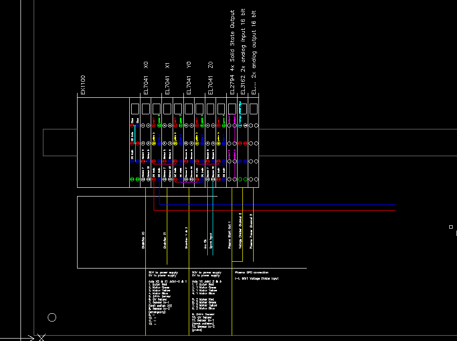

25 Dec 2018 01:28 - 25 Dec 2018 01:34 #122855
by Grotius
Home sequence problem soon solved in running program, how to example.... was created by Grotius
Frequently user's complain about the home sequence. It's also a compilcated item for new user's to customize the home sequence configuration. Information and lecture is limited. Home sequence = -1 or -2??? Or is it both axis? I think home sequence is written in a hurry up time when linuxcnc moved to the joint configuration. Many thing's have changed sinds that time.
About the home sequence :
The machine can not be moved when a mill is drowned into a workpiece
accidently, even after you restart Linuxcnc, homing looks impossible with mill drowned into workpiece.
A temponary solution is to multiply startup icon's on your desktop. One for homing, and one for no homing.
But i don't like this solution. There must be a better way to perfectionize the home sequence anyway.
So to solve this, i am thinking about a solution.
This week i will write a new home_sequence component based on the external offset branche.
It homes all joint's separate and joint's can be coupled together for XXYZ or XYYZ machine setup's.
The output is a home sequence that can be done by clicking a button, whenever user want to, machine can be homed and moved all time. Also it get's the limit switches into the component. When hitting a limit switch, machine can be moved back.
The main feature of the component is :
1. If you startup linuxcnc, machine can alway's be moved directly without homing first.
2. If you want to home the machine you click the button, and homing procedure starts.
3. Homing sequence is saved in a configuration text file, this file has the setup, home speed's, offset's, sensor input's etc. everything.
Hmmm, i like this idea....
Last edit: 25 Dec 2018 01:34 by Grotius.
