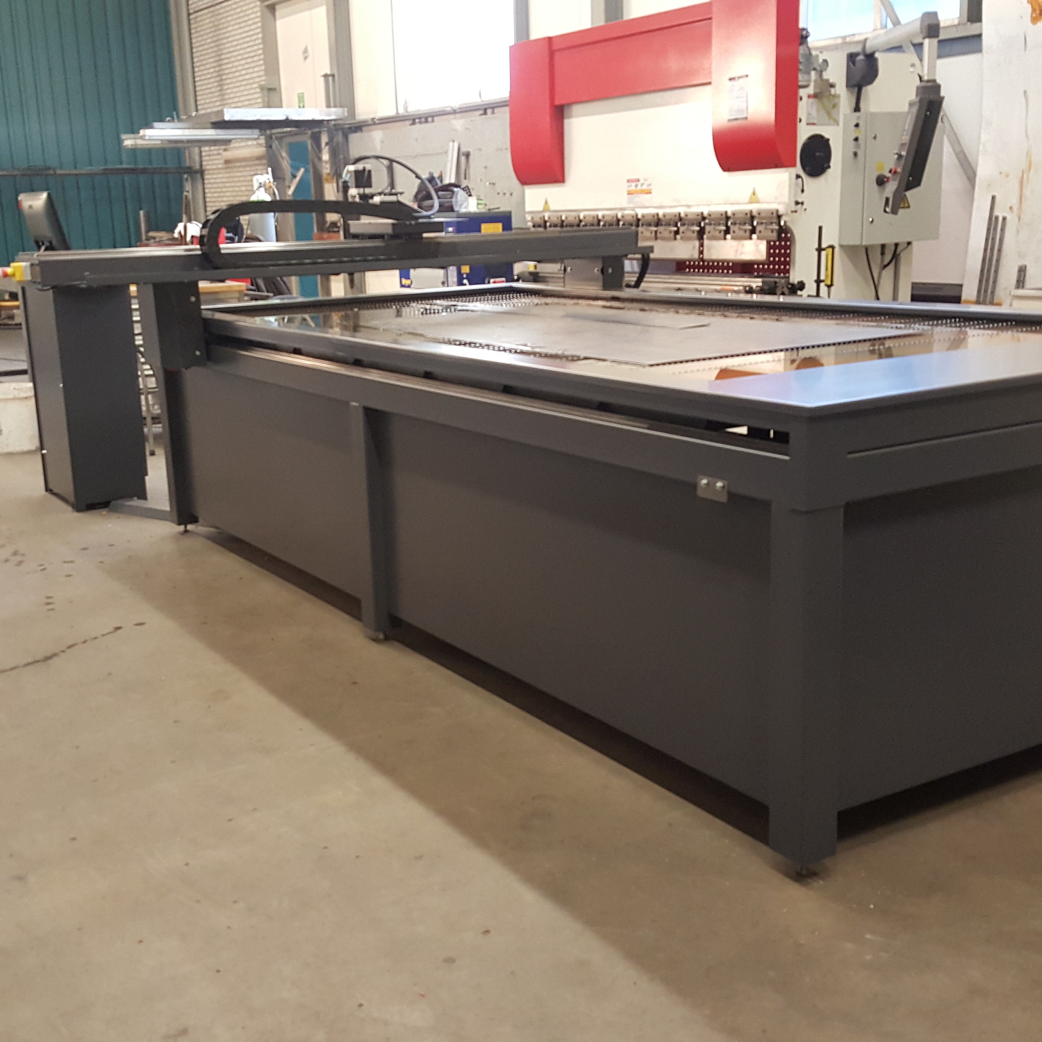

Norbert,
What are you max dimensions for a plasma machine to get it in?
Can you get in 800x1500mm? or 800x2100? Then you can get a machine with 2 test area's.
If you can get a bigger machine inside, alway's better. If you have dimensions i can look at it.
One area for testing plasma, but most important the area for timesaving. This is making a picture of the product and
mill it once at the edge. I have done some work for this, and it works in linuxcnc. See the picture of the "bug" in other thread.
I like to send Rodw a Thermal Dynamics 40i inverter. This is really a good product.

It's the Thermal Dynamics / Esab 40i i have cutted one week with this instrument. About 60 sheet's of metal in ranche of 2 and 4mm.
With 120 amp's i did 20mm test cut's.
I can be honest to say it has no start failures. Hypertherm has every 100-500 start's a start failure because of external spring design on the electrode. The new copper plus electrode is even worse for Hypertherm. The new service agreement is so worse that i am going to stop with Hypertherm. My client is waiting 3 weeks now for new air valve after using his hypertherm 3 years. It's a shame.
About Thermal Dynamics.
This plasma inverter does not know about start failures. And that gives me a boost.
So i am in contact for making a connection with ethercat with this inverter next week. You could use it on the Mesa too. But you know i want you to use ethercat somehow. It's like a roll's royce aircraft motor. It's beautifull.... men.
The 50 pin ribbon cable gives me hope to make a connection to the marking option. I will hear it from the developper's.
I have ordered 2 extra for stock with lead's 15 m1. 40i and 60i. 120i is sold already.

Sorry for the thread hijack. Just so you know I run a TD A-60 ( an old model now). It has been rock solid for 10 years now. I use a HT Duramax torch and mostly use the Finecut consumables on 2mm HR sheet steel. I can safely say that I have never had a start failure. Most of my work has 500 to 2000 pierces per sheet so I would have seen it happen. The only problem I have is the slow reaction of the ArcOK signal from the power supply, even with zero pierce delay I still get a small pierce "divot". Of course this would be a non issue with thicker material.
