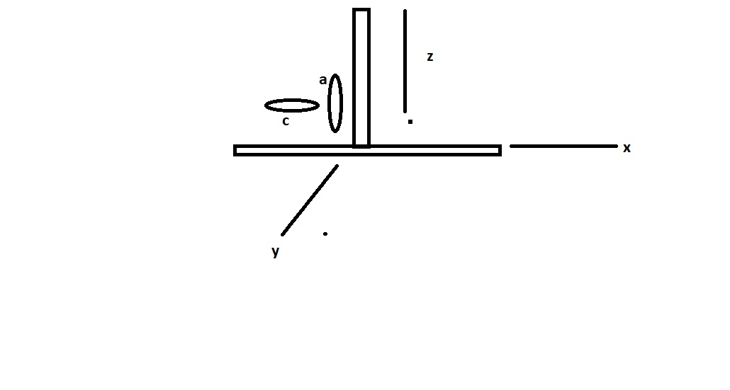

I am a fresh start , and have managed 3 axis milling with success , way more than what I expected
the machine is running fine how ever in step config there is X , Y ,Z and A but not B
the mach 3 breakout board has an output for 5 stepper motors
Please guide me how to do the A and B axis

You need to post a Image of the Mashine setup in Schematic
so we can see how the Axes are mountet to the frame
As speeking XYZ Gantry with 2 Rotarys on Frame table
or A mounted on X Table Moving
BEST for 5Axis is to use 2 items 5Axis mach3Bob so 2 Parport with a 10 USD interface card

Tcp is the best if you can get a post or write the logic for it

this does not say anything on your mashine setup
or tention to go for
you good 5axis simulation in linuxcnc live DVD so try this with your G-code from iinventor CAm first then you see if it workes out of the Box

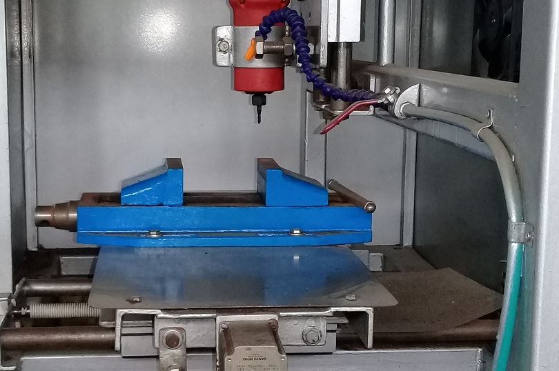

The picture of the machine , sorry for such a horrible delay in my response , some time cancer binds me to static and then i can not go to the workshop . but now I will be completing the project of 5 axis it will be big , this is only a model.
